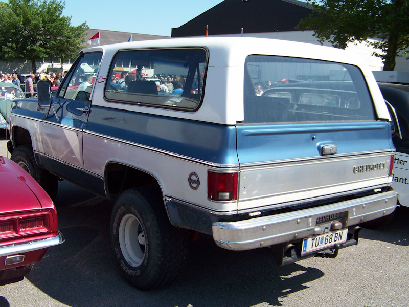

Of the tailgate of a blazer / jimmy around 1974 to show where the white stripe and trim lines were on the tailgate then onto the quarter panels.
The upper is evident, the lower is not...
no...I need a straight on closeup, those brochures don't get in there good enough.
Like that Maybe.
You talkin' about like this? Sorry they're crappy resolution, old pix.
I see what you mean about the brochures; GM didn't wanna show the Blazer's butt at all! :haha:
-- A
Thanks for the pics but what I am trying to find is the exact measurement of where the bottom of the white stripe would be on the tailgate on a 1974.
If there were holes in the tailgate where the bottom trim piece went it would be great....that would tell me exactly where the centerline for the bottom of the white stripe goes.
Also, I think we have already had this discussion, but didn't we determine that the trim piece that goes from the rear lower to the rear wheel well is canted downward at about 20 degrees? Almost nothing, but not perfectly straight??? :dunno:
That's good looking Blazer is that yours?
Thanks guys, but I found the answer....it's on my original tailgate...the holes are exactly one inch from the bottom of the tailgate...one inch on center...
so...wherever that lands on the quarter panel is where it is...
