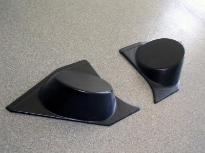

These are cheaper than q-forms , and available at 73-87 chevy . Shipping weight is 30.00 so they must be kinda good .
Who makes em? That's for the kick panel?
pauly383k10 said:
Don't know who makes em , just know that they are 64.99 , and come empty so you mount your own stuff in them .
This is where I saw them Clicky
Coolies, thanks for the link.
