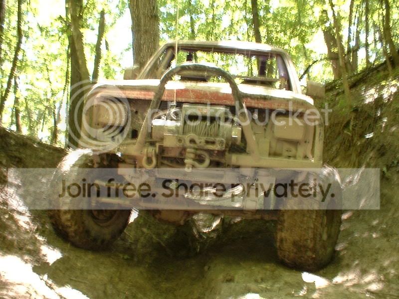

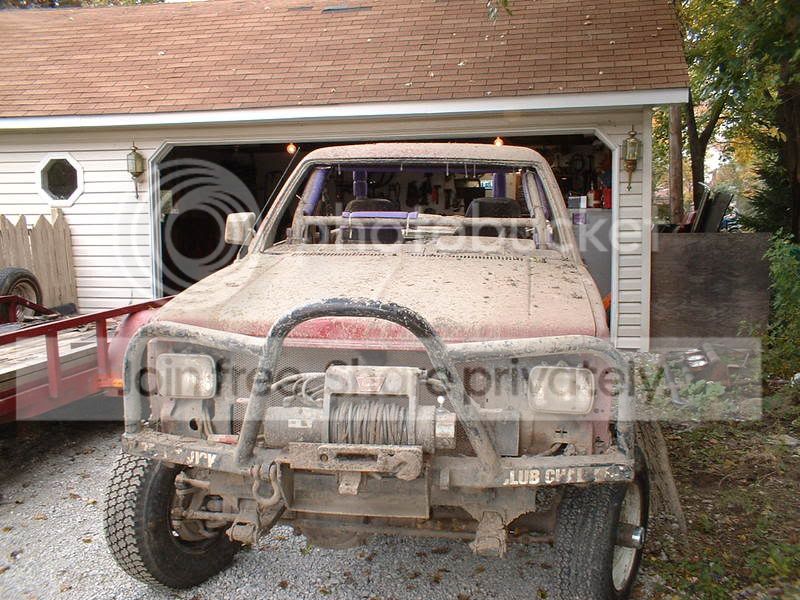

i used and angle grinder with a thin blade to cut slices 1/2 through the tubes and welded them then ground them smooth to bend these.
this is before i painted my truck all black
only tools were the angle grinder i mentioned, a pipe to bend it and a 110v welder
thanks for the pics guys. that is exactly what i was talking about. somehow when i search for bumpers, i can't find all that. gave me some good ideas. what should i do with my turn signals in the front. my truck is an 82 and have them in the bumper. also what about the rear tag light? don't want to get pulled over. anybody got ideas for that? thanks for the help.

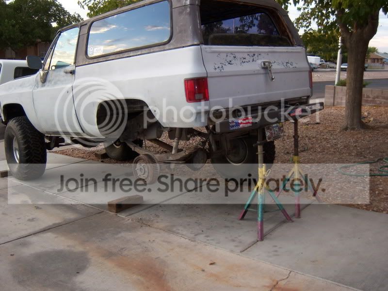

heres the one on my s10 if you want the whole stinger look
