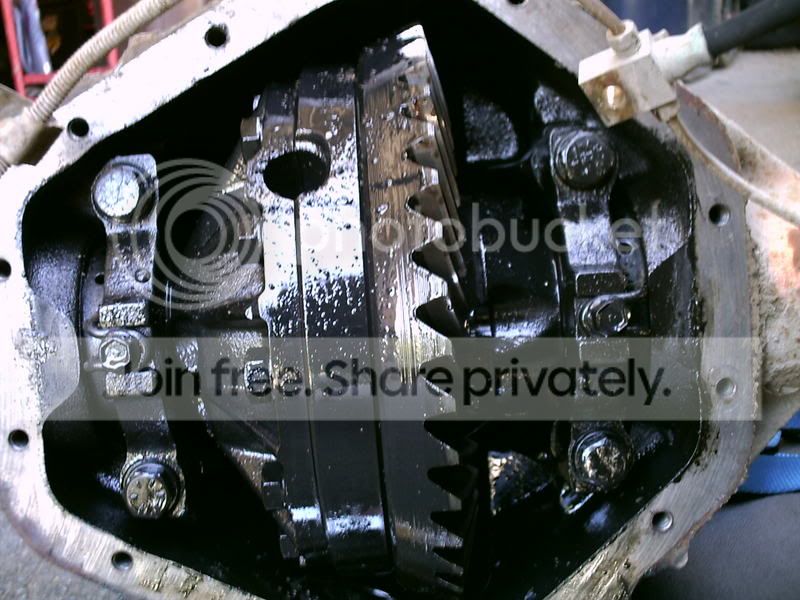

If its not open itll be a govloc most likely. A lot of people say their weak and a time bomb but so far I havent had a problem with mine (only wheeled it once so far but I definately wasnt going easy on it). This is what my govloc looks like (you can tell by the cone shape of the carrier IIRC):
Sorry the pic isnt the greatest, a search for images for govloc should get you some
