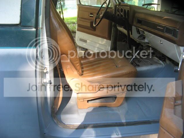

'86 up are different, they sit on seat towers and the pass is a fold and slide seat. The pre-86 the pass side has a hook that engages the floor. You can make the '87 seats work, but I wouldn't say they're a bolt in, or that the floors are 100% the same.

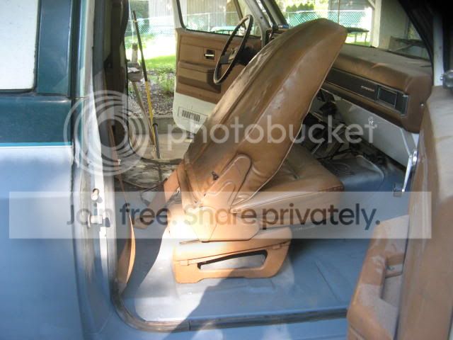

This is what the '86 up seats and bases look like, the driver's is the same except it doesn't slide forward.

The '87 up seats are pretty easy to retrofit, the seat bases only require a flat floor. Other than that it's drilling 4 holes in the floor and bolting them down. The sucky part is usually the cat convertor heat shield blocks easy access to the bolts coming through.
More ideal would be nut-serts in the floor...
Take the time to measure seat location of the old seats before plopping down the new ones. You'd hate to not have them centered properly. if you want I can grab a few quick measurements off my 90.
