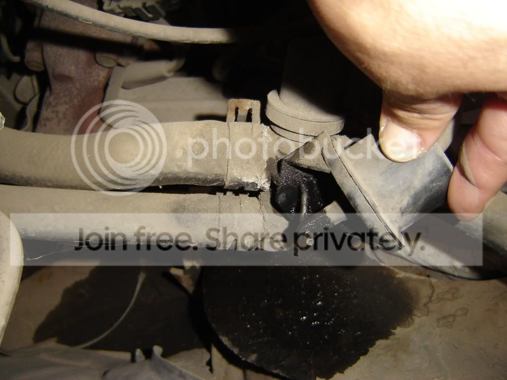

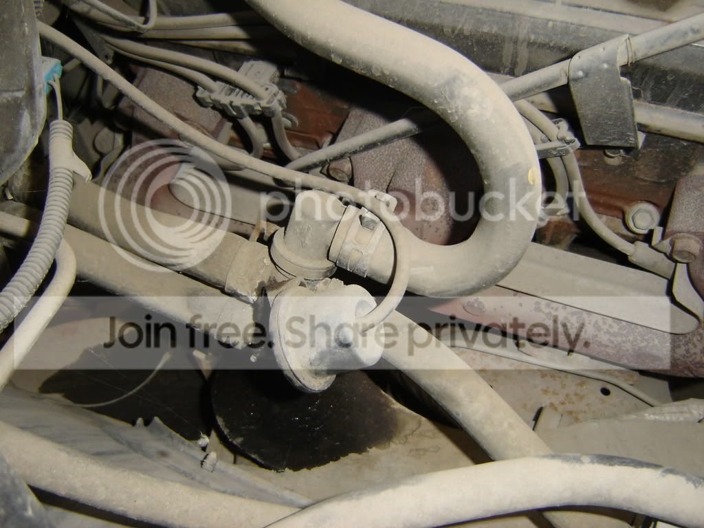

My dad has 97 chevy blazer (full size, mexican version) and we noticed a leak in one of the hoses im not sure if its for the heatter heres a couple of pics hopefully someone can help me out here.
that is a heater flow control valve. when the control in dash is not on heat it turns off the flow to the heater core.
you need a new one.
if you cant find one. plug off the vac line to the unit and install 2 new hoses stright to the heater core or 2 hose couplers.
ya, my moms 98 burb did the samething...i got a new one at my local chevy dealership...i think it was around $30? im not sure though. and it took about 10 mins to replace too.

DO i need to drain the engine of antifreeze or can i just change the valve without making a mess
You don't need to drain the antifreeze out of the engine. No matter what you do, you will still make a little mess.
ya,i didnt drain it, i just pulled the hoses off of it, and got a bucket and drained as much as it would then started putting the new one on
