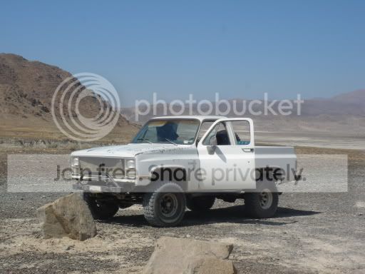

HERE SHE IS AS IT SITS NOW!!!

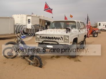

THIS IS WHAT IT LOOKED LIKE WHEN I GOT IT
