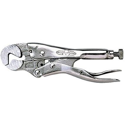

Anyway, I was starting to contemplate a way to build my own tool with half of a 6 point closed wrench on each jaw of a vice grip. That way you could crank it down and lose that last slop that allows it to round out.
For kicks I surfed on "vice grip flare wrench" and came across these:
"Vise-Grip 4LW Locking Wrench"
It seems awesome except that I have a 3/8" fitting, and the version for that size is only 4" long, which doesn't provide much leverage. The next one up is 7" long, which seems perfect, but it claims it only goes down to 7/16".
Anyone aware of something better along these lines?

and I own both sizes in those visegrips.. they actually work pretty good in that kinda situation.. curved ones will just destroy it, those will keep it intact..
