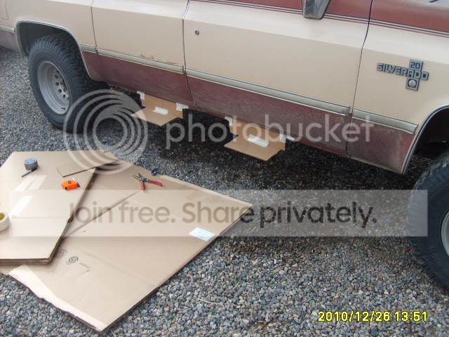

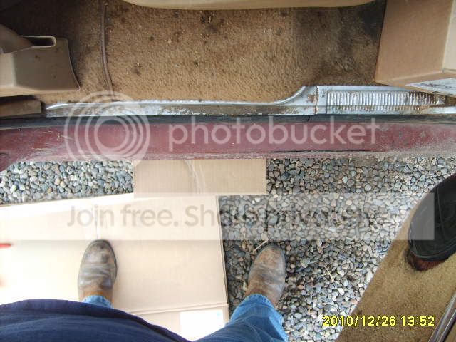

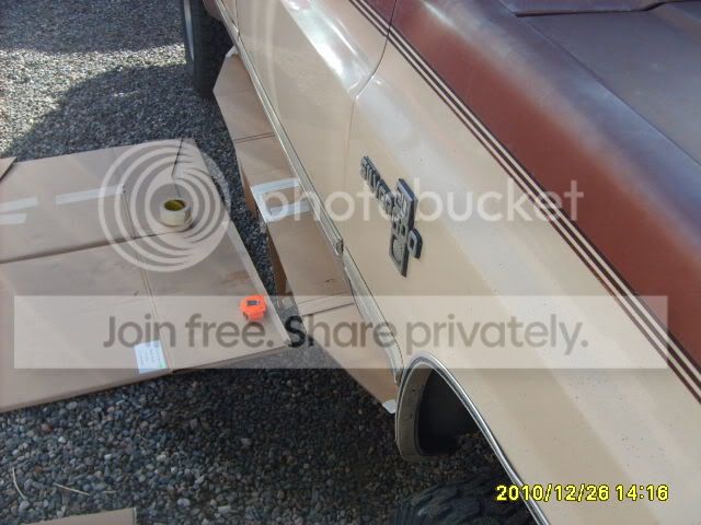

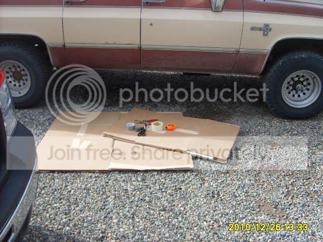

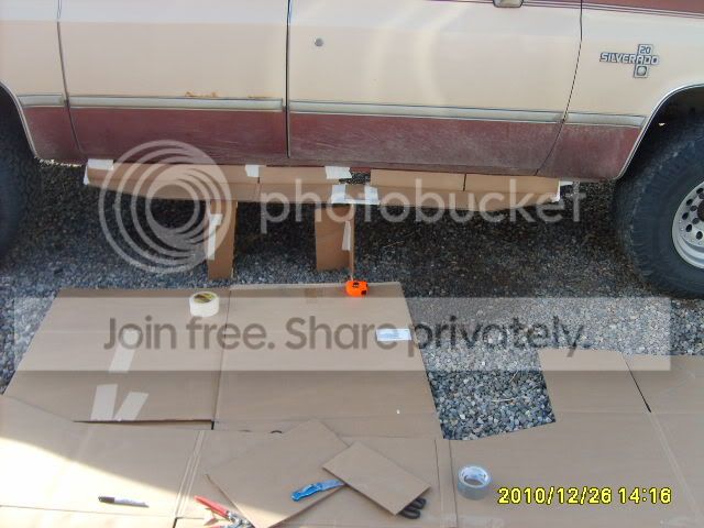

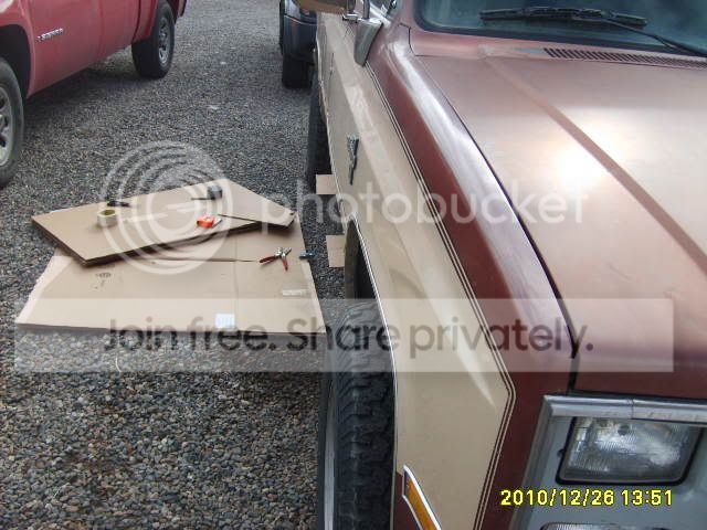

Awww crap!! It's hard to make these out of cardboard! Anyway came up with an idea now, but still gotta figure out the details.
ha ha, first run.
so second try is a little better, the step is 6" wide and 6'5" long, it is hanging down bout 3"
think I like it for now, gonna throw it around in my head what I learned from the cardboard and will be able to come up with some thing very strong and functional.

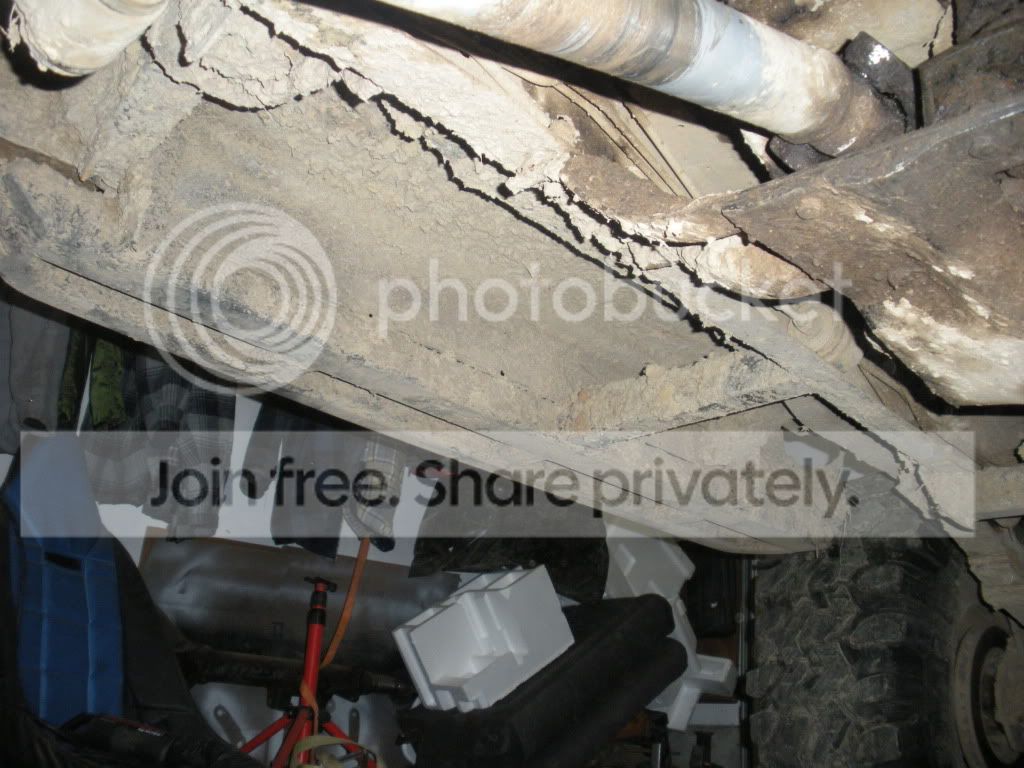

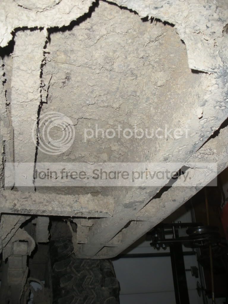

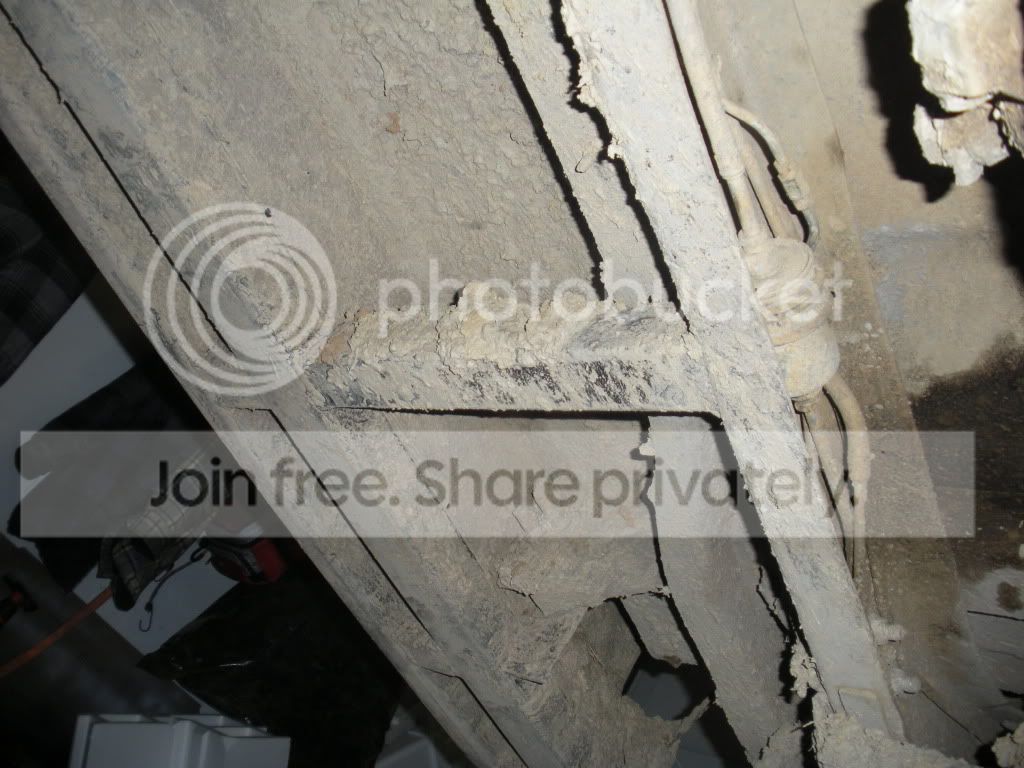

Can you snap a pic of the underside so we can see the tie in?
Sorry it took me awhile, but here is my brace i added in. Was going to do 2 on each side, but these are temporary until I cut the rockers out.
MTBLAZER89 Thanks for the pic's.
Although it may seem like a "no brainer" as far as mounting, everyone has different approaches to the same problem and I like to see as many of them as I can so I can come up with "what seems best to me" when I tackle the job.
