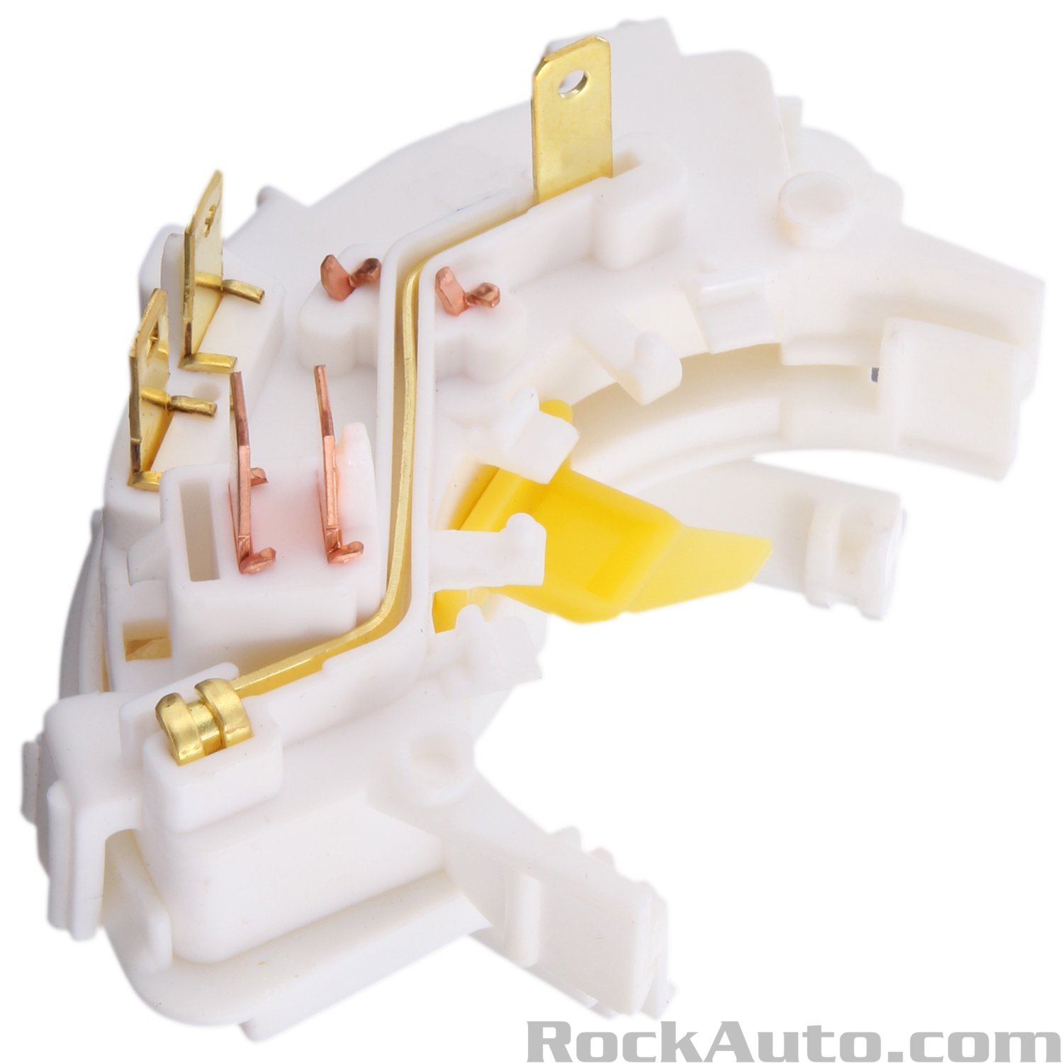

Should look like this...purple wires are the neutral safety wires,the others are the back up lamps..download (26).jpg
Should look like this...purple wires are the neutral safety wires,the others are the back up lamps..View attachment 219978

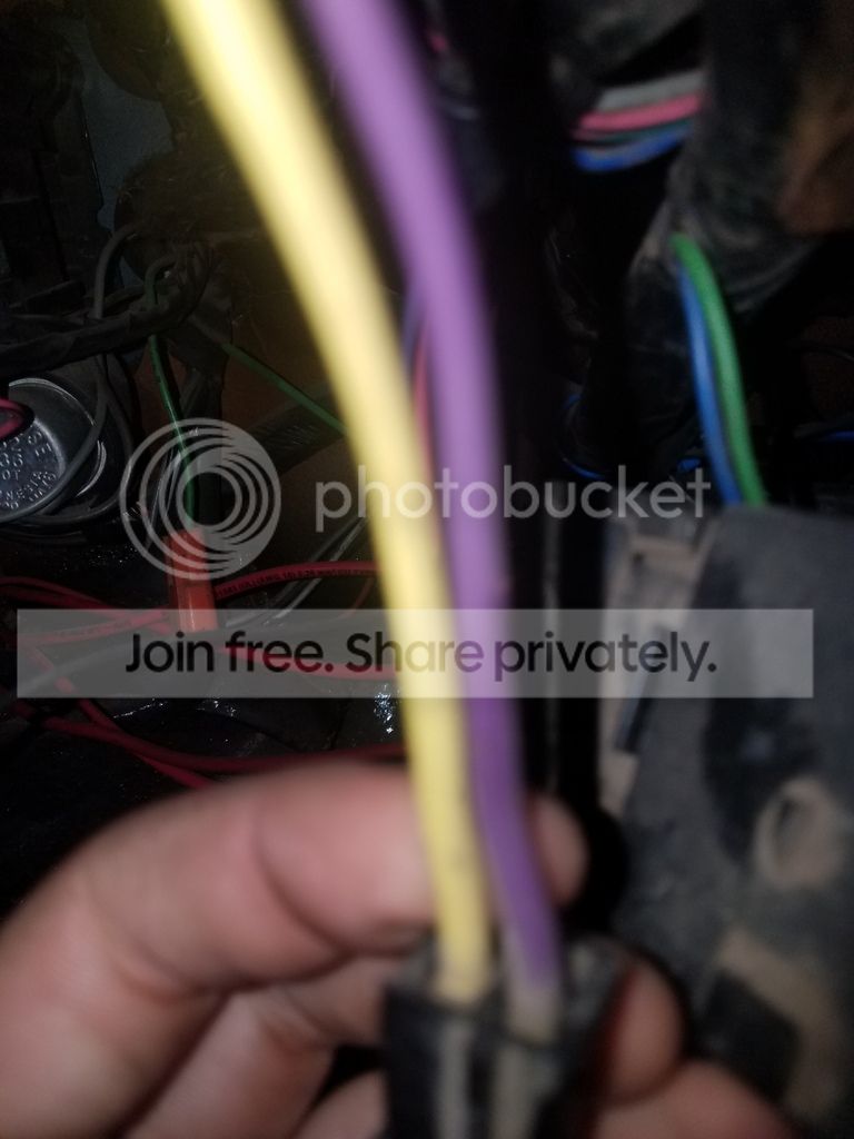

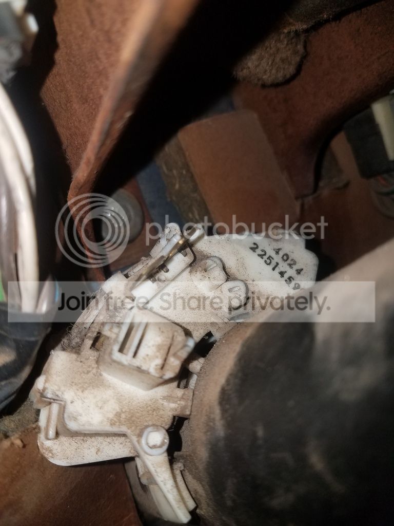

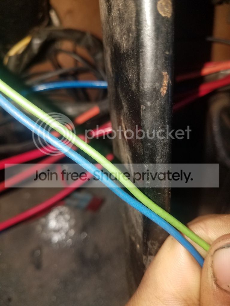

Hmm some reason it wont let me enlarge the photo, on the back of my column iv got a white half disk looking thing (similer to what i can tell in that picture) that had two probably around 8 guage wires running to it (blue and green) those i figured where for reverse lights now iv also have a 10 guage purple and yellow wire running together but arnt pluged in any where, would those be my neutral saftey wires? with the column shifter the truck wouldnt start in gear even though the only wired plugged into the thing on the column by the firewall are the reverse lights (i think) so does that mean it has a mechanical lock out?) ill get pictures up in a bit to clarify
Ok so heres what im working with
those are the purple and yellow wires that i mentiond that arnt currently and were not previously running to anything
these are the wires i mentioned that i believe are for the reverse lights? not positive though
this is what i have at the base of the column at the firewall the green and blue wires ran to the two tabs at the top center kinda hard to see them but they sit right under what looks like a bolt/screw with a washer in the fire wall in the picture

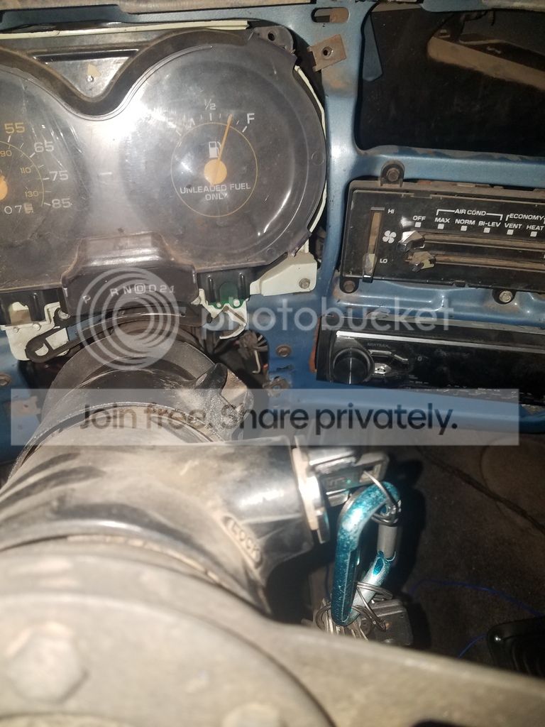

and just for kicks theres the shifter and the the column shifter/lever removed, wouldnt say it looks to bad for a first time hahah about the only shifter i could find that would work with the tranny and fit in the truck to make it usable
The purple and yellow wires are the neutral safety ones..
I jumped those two together on my truck so it starts in gear and park & neutral..I know it's "unsafe" but I have my reasons..
Fair enough haha ill hook em up then and see what she does
