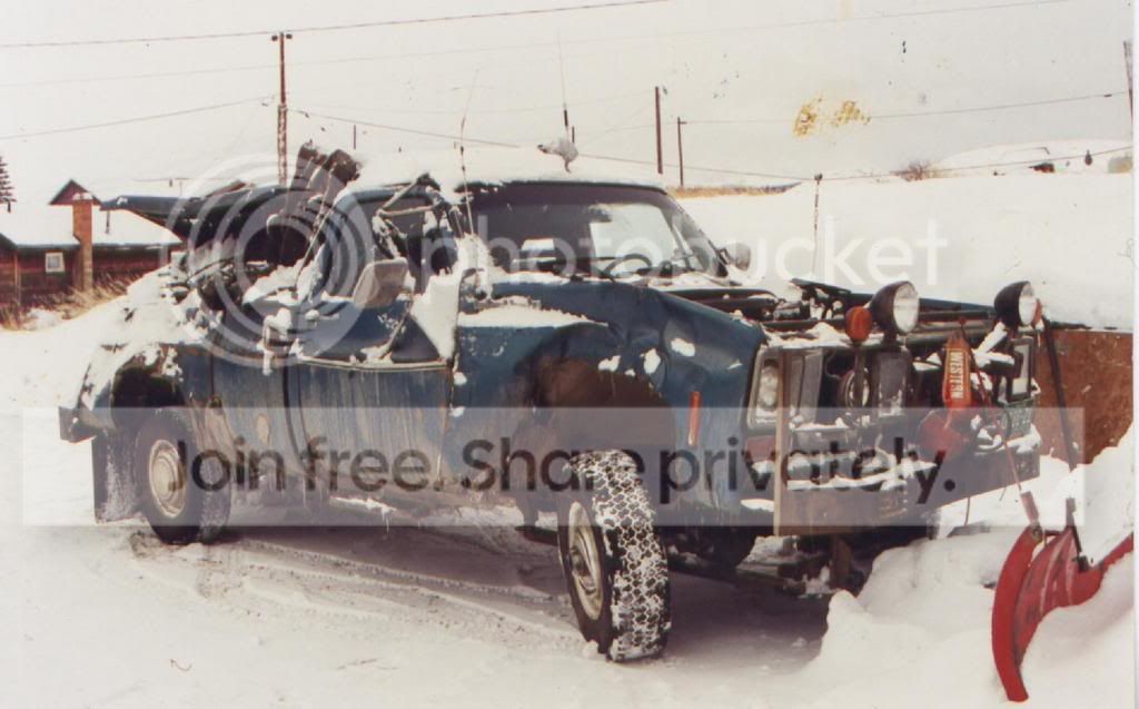

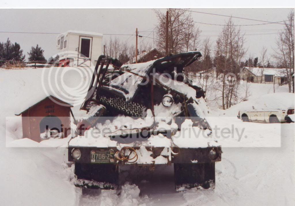

Here is what my 73 looked like after a backward corkscrew roll off a hill into trees at 50 miles per hour. (back in 1996)
I popped the clutch linkage back in and pulled the hood off and drove it home from the tow yard.

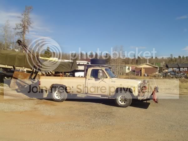

Here is what it looks like now. Last year I had to weld the frame back together after completely cracking both framerails apart. I towed 60 vehicles with it last week.
