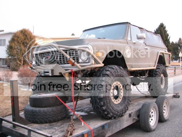

Mocked up my wheel and rock ring in one tonight. Hope to have wheels finished next week, gotta finish cutting down runflats and weld on rock rings.

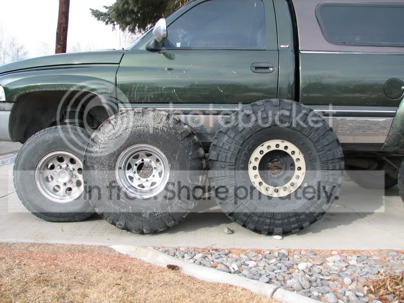

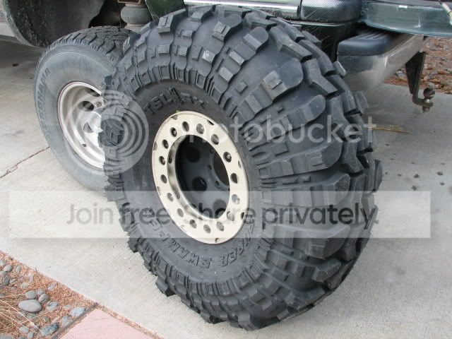

43ok, here is a pic next to a 35 and a 39.5. Measures 42.25 roughly mounted with 15 psi
Nice looking tires, i'm thinking about getting a set and running them on h1 wheels as well for my toyota build. I was wondering if you could get me a measurement that i havent been able to find yet. I'm looking for the overall width of the tire mounted up on the h1 wheel, just like you have pictured. If that isnt too much to ask, then i appreciate it. Thanks
Just ran out, its 15.75" at the widest parts of sidewall. That is with truck weight and at 15 psi.

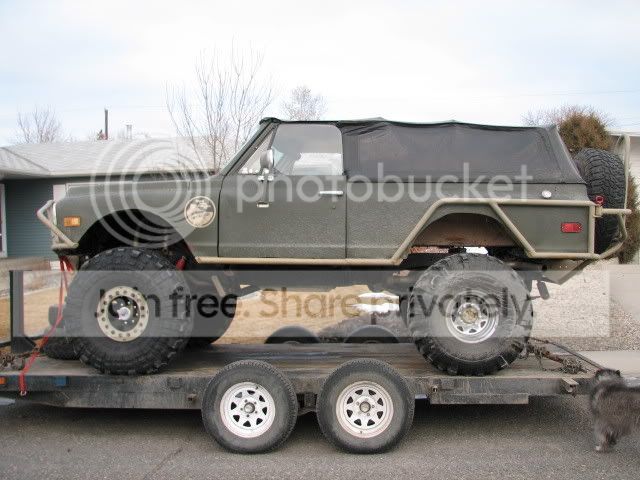

Got front ones on last week amongst new chromo 35 spline shafts, new kingpin springs/bushings, pack bearings, new flanges, and install shock hoops.

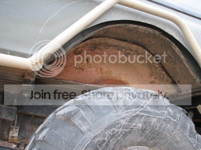

Got the rear end tubbed in an extra 5" today so I can clear the larger tires. Rubbed them hard already with 40s. Just gotta finish cutting down the runflats and get rears on.
This pic looks bad ass, those tire look tough! Rig looks bitchen! I want some of those.
