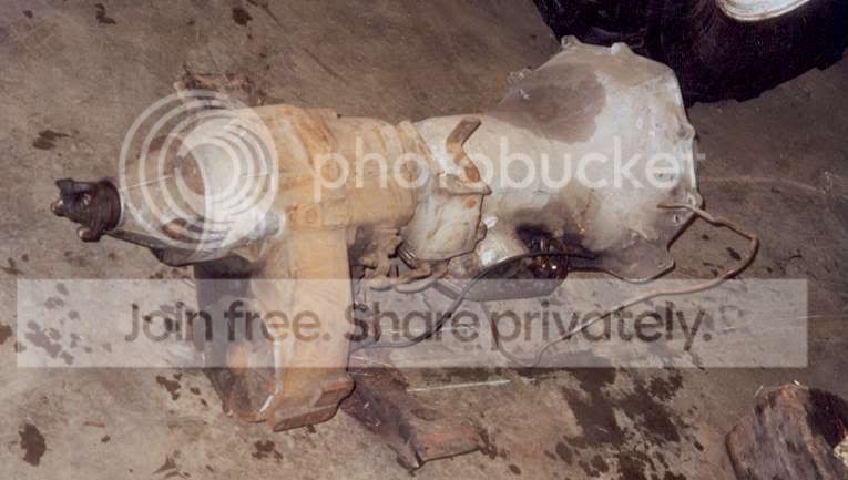

No transfer case looks like the 205. The 203, 208, and 241 look very similiar to each other with a large planetary box attached directly to the trans, then the torque splitter portion with the chain.
NP203 behind a T350:

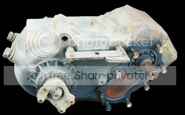

NP205
Notice on the 205 that there is basically no extension off the input, it is flat across the front to the front output. The 203 has an extension, then the differential/chain section with the front and rear outputs.
