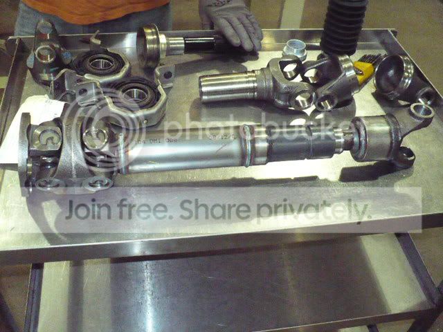

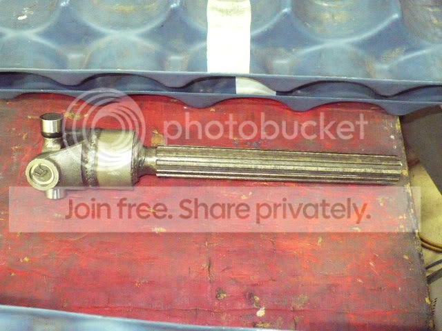

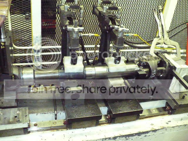

Here is the front Shaft that i am making for my truck i am using a 1350 D/C joint and a 1410 joint at the axle, this has a 12 inch slip shaft this should be enough for my 52 inch springs
High angle drive line long slip spline shaft

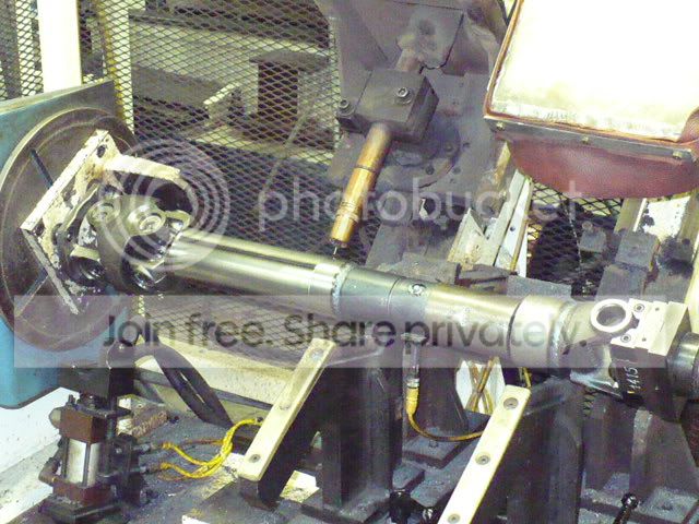

My front drive shaft in the press up machine

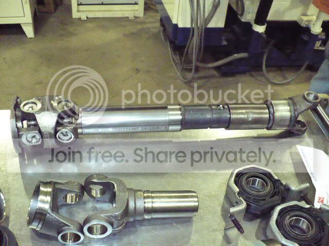

Front shaft all pressed up and waiting to be welded

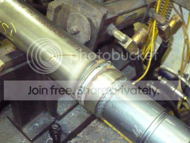

Shaft in the welder getting ready to weld it

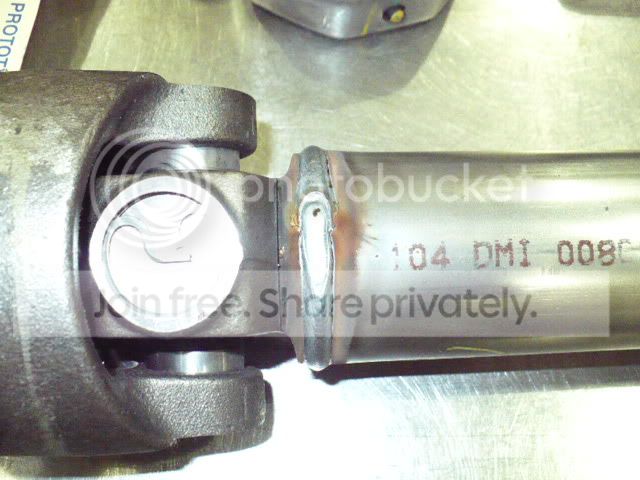

First weld on the shaft done, becasue it is so short only one weld head could be used at a time
All welded up and ready to be balanced
