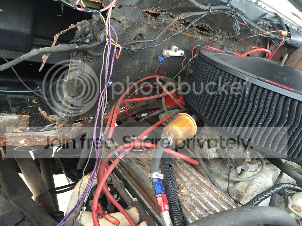

well, i went to pick up my truck from storage so i can do a little work on it over the weekend. when i got to storage, i fired her up and smelled gas, so i popped the hood. the clear plastic fuel filter and old lines were leaking all over the pass valve cover. looks like a hose clamp busted through a hose. so i ran to the auto parts store, purchased a new filter, new hose clamps, and some 3/8 fuel line. the old filter was nasty brown inside anyways.
well, got it all on, drove her about 12 miles home, and as i was pulling in my driveway, she died. wouldn't start so i popped the hood and noticed the filter was only about 10% full. finally got her to start but had to keep revving it to keep it alive. now that its in the driveway the filter will fill all the way up, but wont start or keep running unless i give her some gas.
i tried unscrewing my gas cap b/c i had some type of vapor lock in the tank on an old carb'd car.
also, the lines and filter are run exactly as it was before.
thanks!!!!

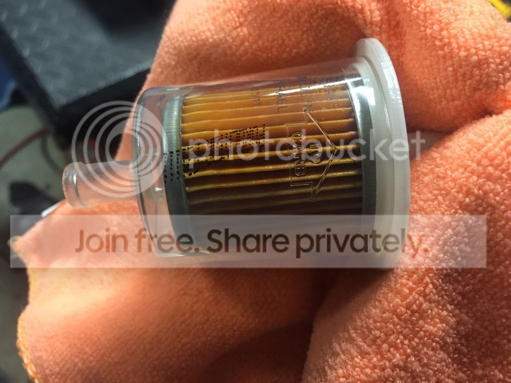

i just pulled off the filter. it looks like fuel goes from the outside to the inside. I also have a picture of the old filter.....
first pic is the filter that i put on this afternoon.
second pic is the one that was on the truck from the PO

I dont know,that filter looks pretty clean to me..(unless that photo was taken before it was installed)..

That's the same filter I temporarily installed on a boat here to flush out the tank and keep an eye on the debris coming through from a badly rusted tank. It does flow from outside inward. You'll be able to see any rust particles in it if you have them.
