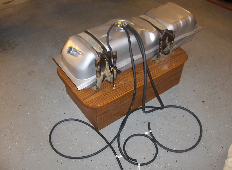

This is the LMC ’87 TBI fuel tank I used back in 2008 on the driver’s side. It just looks to be painted or covered in some cheapass material the usual LMC way :rolleyes:

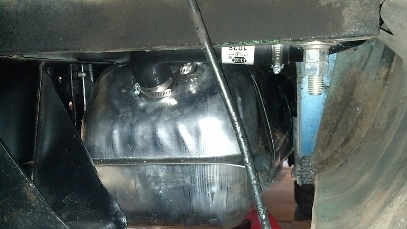

This is a crappy picture of the much better Napa ’87 TBI fuel tank that I installed on the passenger’s side yesterday. I am tempted to order another and replace the driver’s tank with this much higher quality Napa tank :dunno:

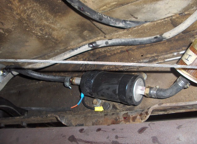

Reliability and frame mount fuel pumps do not go along in the same sentence, no matter how much you pay for a high dollar frame mount pump. I’ve used frame mount pumps twice on projects and they were never reliable. My buddies that have used them on other projects had the same results…use a frame mount pump then 2 months later change to a in tank pump with a tried and true AC Delco fuel pump. That is the entire reason I went with ’87 tanks with an in tank pump in the first place because of reliability and noise of the frame mount pumps. Save up and do it right with a new tank and in tank fuel pump.

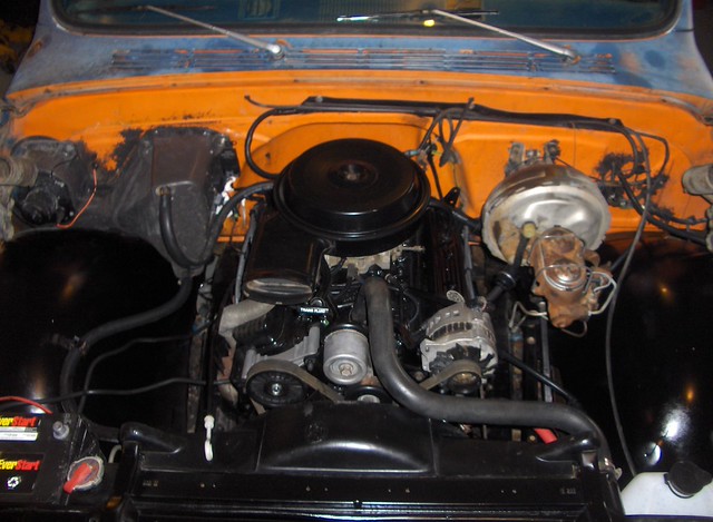

More picture porn….
When my K10 had an EFI L29 454 it briefly used a frame mount pump tucked up behind a crossmember. It had a habit of not starting after you turn the truck off after a long drive. Ditched it for an in tank pump and have never had a problem in 6 years and 30,000 miles.
Then my old ’72 C20 beater truck TBI 5.7L/700R7 swap project I used a frame mount pump that was sucktastic as well. The pump worked fine for 5 months then crapped out. Replaced it again with a warranty pump from Summit then sold the truck. Not even a year later the guy I sold the truck too popped up in my email one day looking to find out what brand of fuel pump was on the truck so he could order another as it failed again. I believe that one was a WABLRO pump. The only thing good I could say about the WALBRO was the fact it was quiet. Especially when it died :haha:
