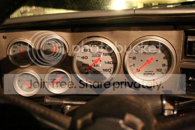

Going to order some new gauges tonight from my buddy (he owns a parts company). I was going to measure the openings on my 74' blazer dash to see what size to order, but maybe someone has already done this and can give me a heads up on the correct size? I have included a picture of what I would like...minus the shiny chrome.
IIRC the small gauges are 2 5/8" and the speedo and tach are 5". Whos dash is that anyways?
Thanks 4x4...you sure about the size? I found that dash the other day when I did a search, I believe it is ARAMP1's, at least he posted it. I really like the way it looks but I just want the stock black plastic. In the future I will get a carbon fiber or fiberglass dash made after I do my cage.
when i did mine, the 2 1/16" are what you need for the small guages if you want them to fit in the factory pod circle otherwise your cutting the holes bigger for the 2 5/8. For the Big ones in the middle, I ran 5" guages, if you want them to fit inside the hole, id get 3 3/8" guages.
mine are 2 5/8" for the small ones and 5" for the big ones
