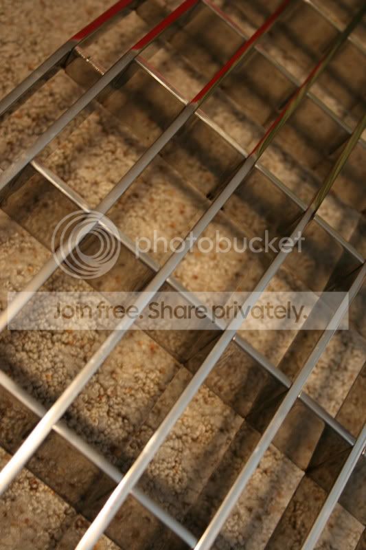

new grill concept
Did you have to modify the outer grill in that picture? I'm still interested in an aluminum one in the next few months.
no, that grill is built to fit perfectly with a stock outer grill.
Unfortunalty i cant show it mounted with a good outer grill as i dont have one. The outer in the pic is hacked up to take a tube grill. (i bought the truck that way)
If i work out this trade and end up having to build another i will probably go aluminum this time and do a clear ano on it. who knows.
if you missed the thread, this is one i made for igor out of stainless, then he sent if for a polish. it looks fantastic.

finally picked up an outer grill that was not hacked up for a tube grill. its not the greatest but at least all the pieces are there. it appears this is the final design. next step is to make an aluminum one.
looks good... i do love that cowl you did... props...
Those are smooth. Makes me want to give up my wannabe billet grill.
i have an aluminum one coming soon. Its programmed and sitting in line to be cut.
The problem is our laser are so overloaded it could be a few weeks. Anyway. this probably means im selling the one seen below.
