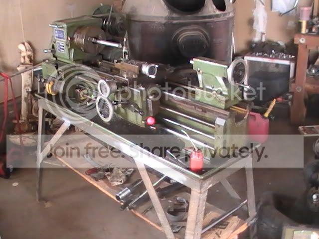

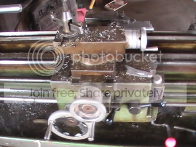

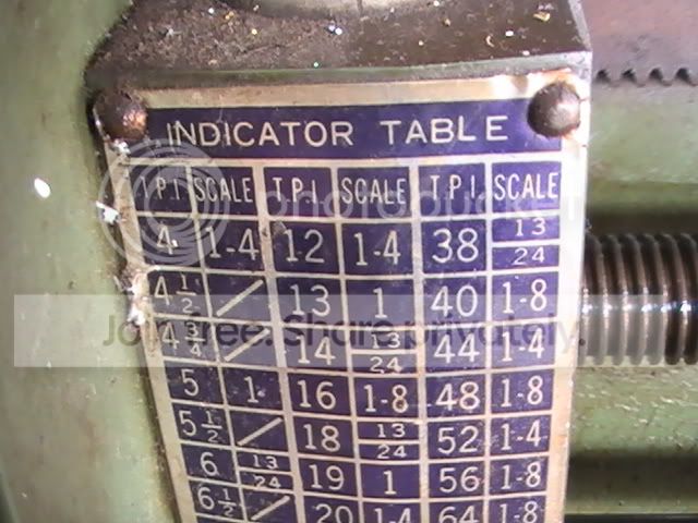

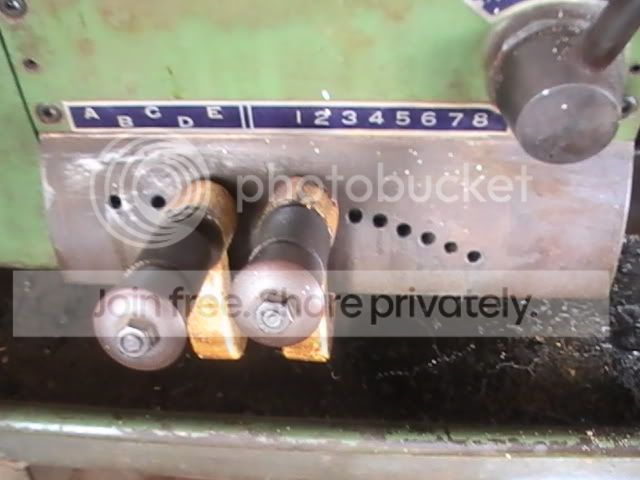

I've been messing around with it some, But I have no owners manual, and really want to learn how to do threading! You can kind of se my tool holder in one of those pics, what all do i need to get to do threading? and, How do I read those tables and adjust the speed and stuff?

Single point threading is a process that takes some learnin' for sure, but it's awesome as hell to thread a piece correctly and have a nut screw right on. Both of the books I mentioned should cover it in detail. You are gonna wanna ditch that lantern tolpost and get yourself an interchangeable toolpost. I have a KDK toolpost, and I like it a LOT. Quick change toolposts save you a lot of setup time when changing tool bits.
That indicator scale lets you know when to close the half nuts when threading. To do different thread pitches, you put the A-E and 1-8 levers in their proper hole according to the on top of the gear box, it probably says "threading chart" on it. You will learn all about this stuff, including grinding your own HSS lathe bits in either of the two books I mentioned.
