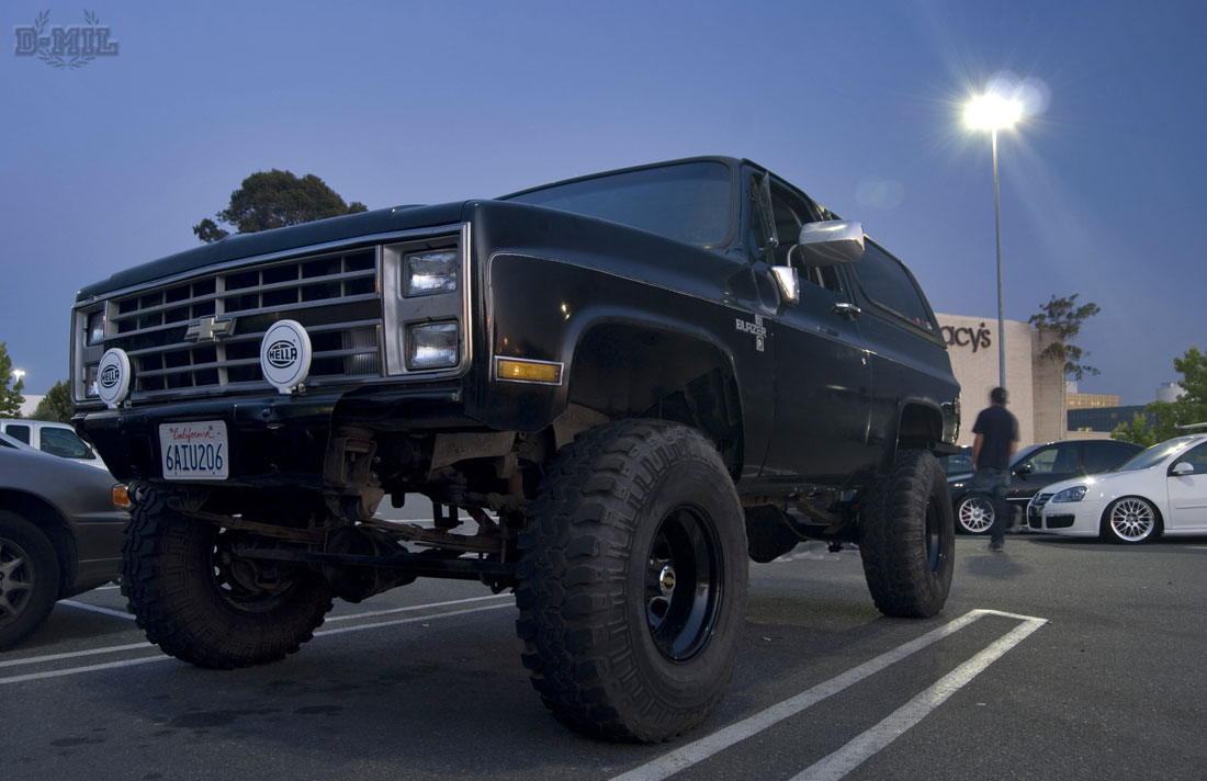

Enough rambling, here are some pics from the P.O. since I haven't taken any yet. Thanks guys for the help in advance!

someone stole that nice truck from long island?! haha nice truck
Not sure when it left, it has some rust that was repaired ny the tail gate. It has a small spot in the roof by the seam and a little in the rockers. Nothing major. Perfect for a trail rig.

truck looks nice.
