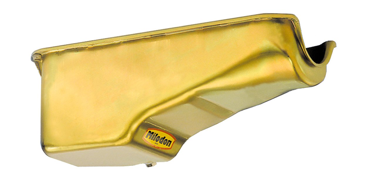

My current oil pan is banged up and seeping from various places. I was thinking of getting a nice one like the one below. Any opinions? Are there any gotchas in terms of fitment based on the engine or anything? I've never swapped the pan on a 350 on-vehicle, I assume I can just unbolt/rebolt, or is there more to it?

That will work, but you can get a stock replacement pan and a one piece pan gasket for about $80.00 through Jegs. Milodon does make good products though. It's not to bad of a job to remove and replace, you should have no problem. Which ever one you go with, just make sure which side has the dipstick provision for your application.
This truck's a project, and part of the fun is attaching nice parts. I have been burned in the past though, and wished I had just used standard stuff. Partly I was thinking I'd like it to have a nice stiff mounting surface to get a good seal.
