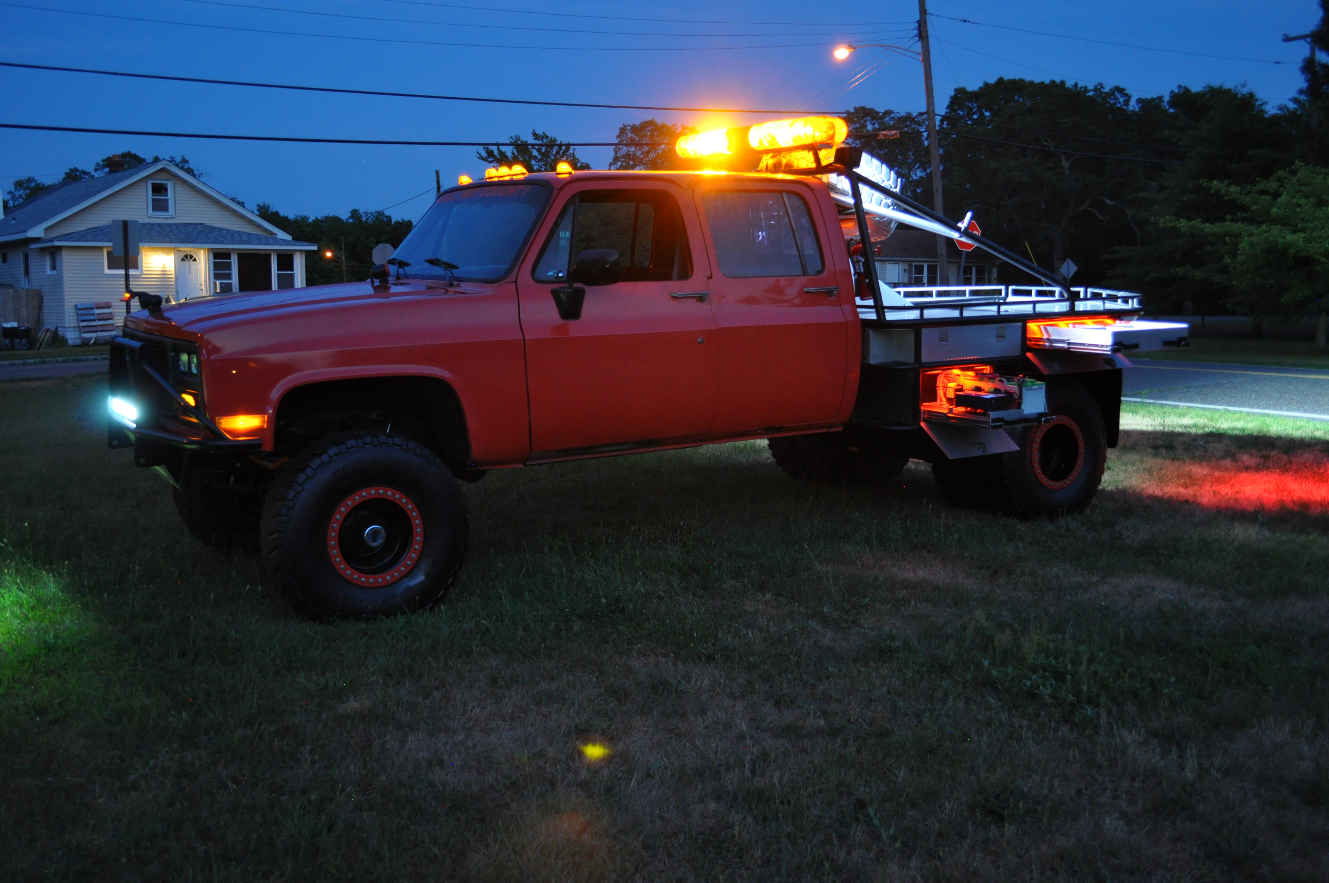

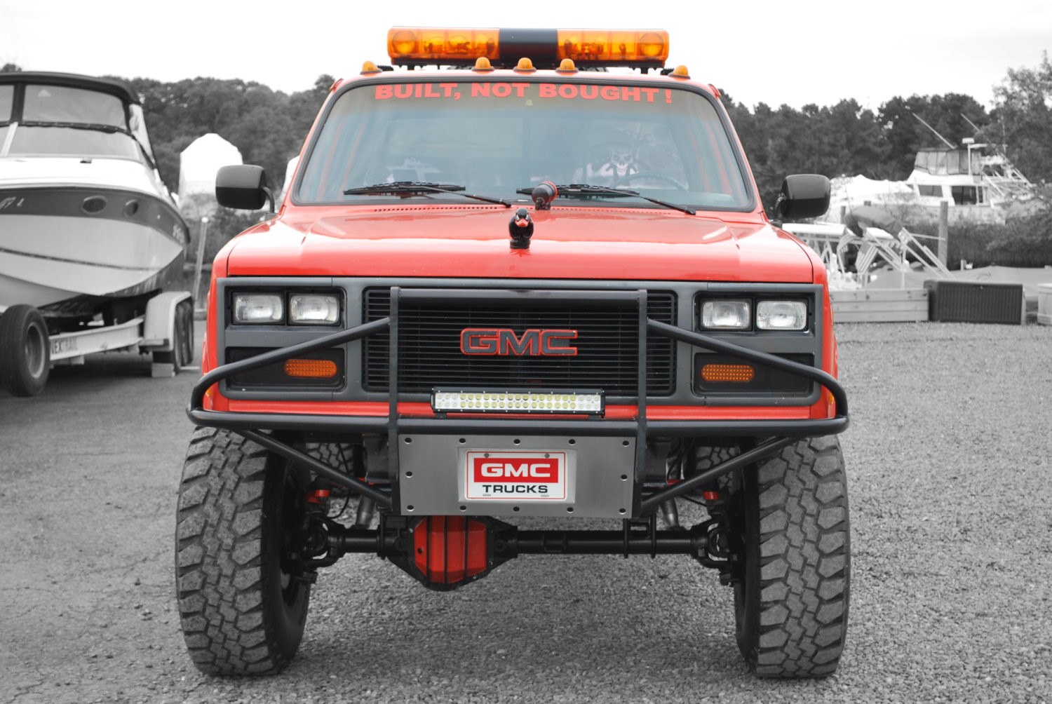

all I'll say is I DESPISE the individual LED headlights... goofy looking... there are some better ones that have more of a look like the originals when off... someone will post a link to some.. guy on FB's Squarebody Nation makes some cool headlights..
but I do run just about everything else in LED, including the mallard.. ;) keep in mind, if you run all LED, you'll need to add a resistor to the system...
