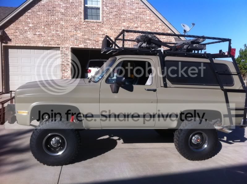

Its been awhile since I posted here. I have used a 1989 K5 for about 12 years for hunting and four wheelin. I decided it was time for a new project and sold the K5 for a truck with bigger back seat and rear doors. I have two kids now so it was time to give them their own door and window. I found this 1978 Suburban on E-Bay. A friend of mine drove it 1700 miles home to Texas.

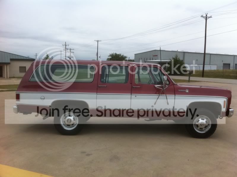

Overall it is in great shape. It was advertised with 65000 miles and I have seen no reason this is not true but who knows? It has been painted once and has a nice 454. I figure if it made the 1700 mile trek from Key West to Dallas it has to be pretty solid. I was told it was only in Key West for two months and originally came from the state of Washington. The original owner did a nice job and it appears well taken care of. I have to fix some leaky headers first and then figure out what lift and tire combo I want to run. I used a rough country 4" all spring lift on the k5 with 35" tires. I was thinking of going with a 4" Tuff Country this time and 35's again.

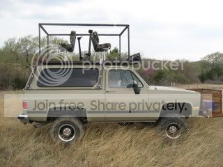

I was sorry to see this one drive off into the sun set. I owned it since 1999 and made alot of memories in it. Besides alot of hard work building it just the way I wanted it. The use the high rack you swapped the short legs for 38" ones and put pedastals under the seats.

I wonder if the previous owner was ever a member here? Anybody seen the Suburban before?
Nice rig...both of them :waytogo:

The k5 was a ton of fun. I don't do a lot of 4 wheelin just for fun, but I can always find my truck in the worst spots trying to get where I want to go on the other side. Mostly at night not looking for zombies as much as coyotes and bob cats. The blazer had 4.56 gears and eaton posi's and it was pretty ruthless for most of the situations I ended up in. In the bottom picture it was sporting 34x10.50 super swamper LTB's. They were awesome but the 35x12.50 bf goodrich mt rode and looked a ton better.
