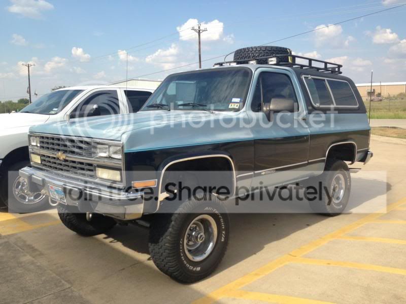

I sold my 78 Suburban from the classifieds, lost some of the proceeds to my better half, started looking for a K5, and ended up with this one in the driveway.....
I wanted another K5 because I had my 89 for over 10 years. I sold it to try a suburban and then tried a jeep LJ. My favorite was the K5. I like the short wheel base, seating for three kids, full size, chevy. So now I am back where I started with my 89 15 years ago. I was looking for an original paint vehicle as I am not fond of body work. This one is straight, with a complete interior, 4" lift, 33's, at 150,000 miles.
Now I just need to decide what way to go?????? I will use the truck for hunting. We varmint hunt at night in sometimes rough terrain but mostly mild pasture road with a creek crossing or some muddy spots. I will also use it a lot on the street. The varmint hunting entails a lot of highway speed travel between ranches. One other thing is I took my jeep to Colorado this summer and absolutely had a blast exploring mountain passes but never ran into very difficult trails. Just bumpy was all and some could have been rough in a stock 4x4 but the jeep well qualified. Part of why I decided to get back into a K5 is because my wife and I are having a third child and the Jeep just seats four. I am planning another trip next summer and will be taking the K5. As with the jeep I will trailer it there and unload it to use the whole time, highway or off road.
