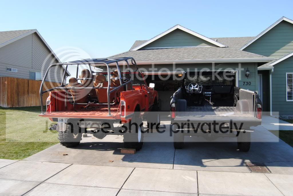

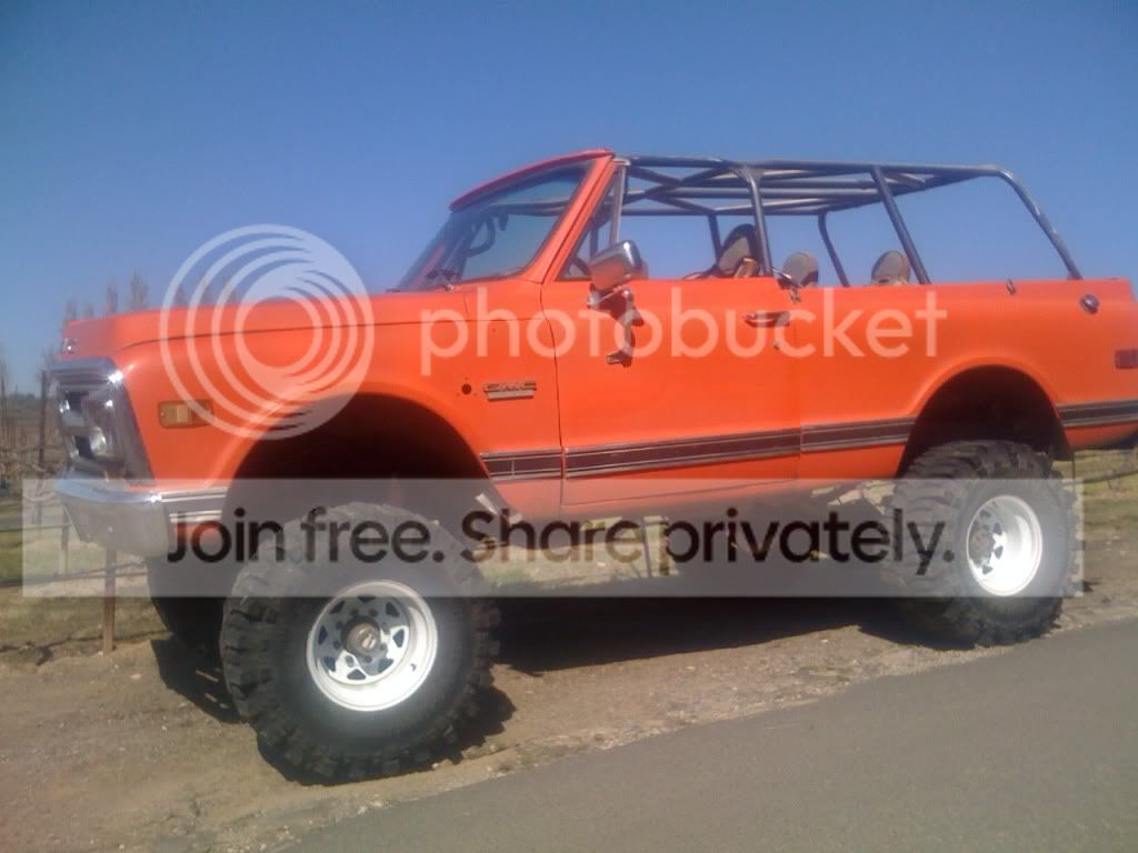

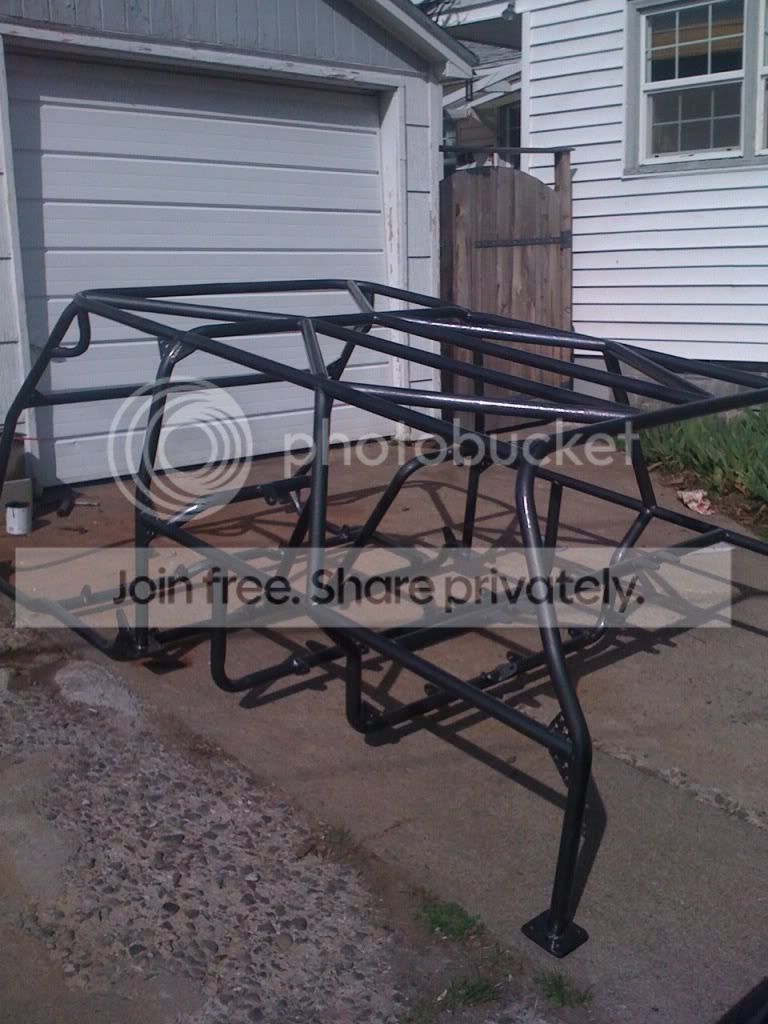

When I get some extra cash I'm going to do a modified version of this one.
Free expert help...
Protecting kids in rear seat...
Full convertable rig...
I'd seriously look into 8 point and integrated seating, even for a street queen. I guess it just depends on how much time your 'help' is willing to put into it for you.
The cage Evil Fish posted up looks damn decent, the big thing to keep in mind on a street queen or daily driver is ingress/egress ease. Another big consideration is designing it so you do not need to have a helmet on to be safe inside it. A blunt force trauma due to someone hitting their head on the cage bars would be tragic irony.
Rene
Yeah big bad, that was done very well. Do you have the same attachment on the underside.
And.I disagree about going to the frame. I think it should be done ALL the time. Regardless of how much vibration and street driving is done. But that's just me

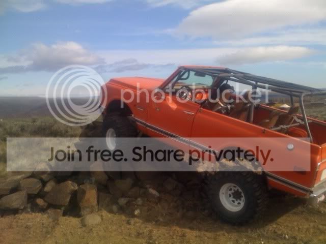

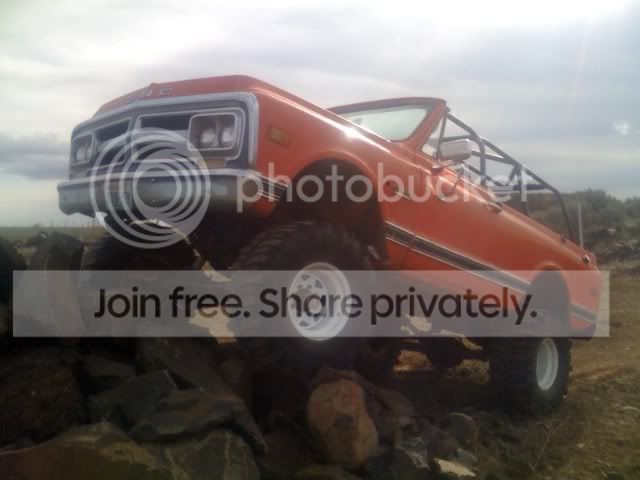

The cage was one of the big reasons I bought the Jimmy, It is now in my blazer, It just has the DIY4X cage plates in it currently, But The cage is just sitting in the Blazer at the moment, it will be tied into the frame when I get back to working on it. The Jimmy is getting redone at the moment.
The nice thing about the cage is that it has the seat bridges in it and the seats/harnesses are all tied into the cage.
