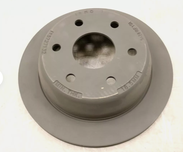

I have some new rotors that have a grey paint or zinc coating to them. This is on a 2001 Silverado. Do I need to sand this off? I'm going to spray some brake cleaner on it. I'm not sure if that is enough.
I usually buy coated rotors. It especially helps in the fins where road salt can get them all crumbly (which has to effect the cooling). I always just throw them on and bed the pads. If brake clean makes it run off, it's just a shipping coating. It's usually the uncoated rotors that ship oiled and need to be cleaned off.
I didn't even know it was an option until a couple of years ago when I bought a set for my 97 suburban and I saw the coating.
I like it.
I used brake clean on the rotors and the painted coating did not remove. I installed the rotors and the new pads with the painted coating on. I need to remove one side however and redo my work. I did not adjust the parking brake shoe.
