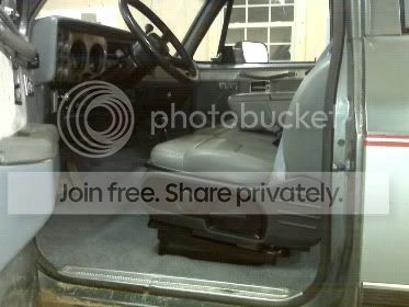

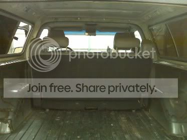

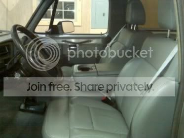

Thought I would share some pictures of the seats I swapped in last spring. I put an '07 Ford 40/20/40 up front and an '02 Suburban in the rear.
This gave me room for six last summer...

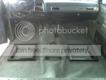

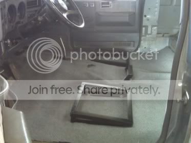

Getting the front seat at the right angle was the toughest part - this is the same seat that's in my DD though, so I used it for measurements

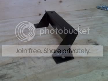

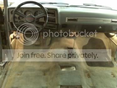

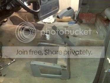

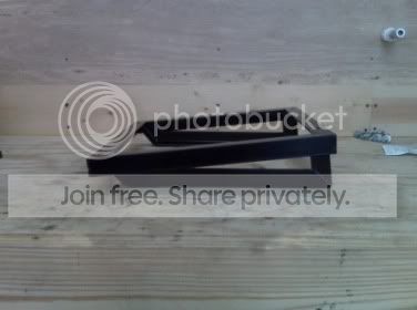

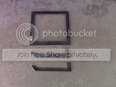

The transmission tunnel was the perfect height for the front of the center console / seat (I based the height of the other seats from this), and added this bracket to support the rear. I angled it so it could bolt to the flat spot where the original console was bolted.

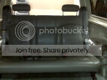

And for the rear seat...

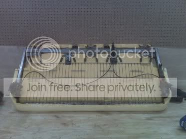

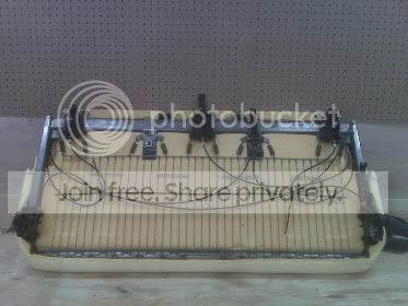

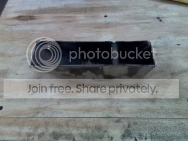

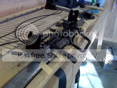

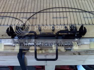

I wanted the rear to be easily removable like in the newer vehicles, so I kept the front latches from the new seat & added my rear latch to it as well.

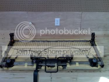

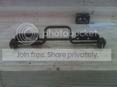

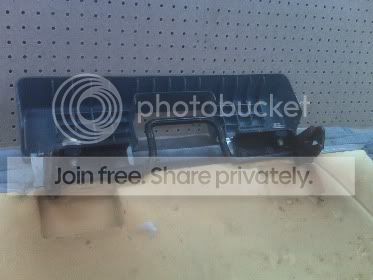

New seat bottom with cover removed - I trashed most of the cables / locks that force you to remove it in a certain order.
Rear latch from original seat.
The new seat is deeper than the original, so I extended the handle so the latch could mount further underneat it.
I also added some bumpers at the rear corners to support the weight where I removed the latches. I used door stoppers bolted to a couple of brackets that I made.

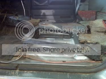

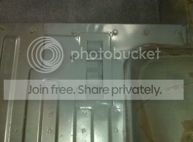

That's it for the seat, now I needed add the strikers in the floor.

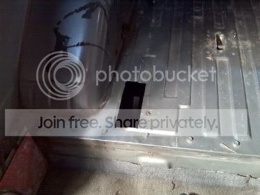

The rear strikers needed to be recessed for the seat to sit at the proper angle. This also keeps the strikers out of the way when we sleep in the back on camping trips.

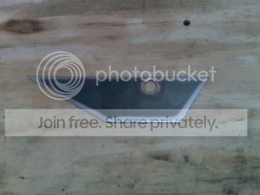

I started by measuring the latches on the seat and forming a template...
I cut the recesses out of 12ga metal.
Perfect fit:
This also gives me shoulder harnesses for the rear passengers even with the top off since they are built into the seat.

I'm confident the new seats are as secure as the originals. The front driver & passenger seats use the original mounting holes and bolts, and there's no doubt my frames are stronger than the original ones. The center front seat is mounted with nuts and backing plates welded underneath much like the oem setup.
The rear seat uses the original latch and strikers in the floor. I used 1/8 plate welded to the seat bottom to bolt the latch to it - stronger than the mount on the old seat. And the recessed strikers for the front of the rear seat are built from 12ga sheet metal and welded securely - they aren't going anywhere.

Yes - I had repaired the floor when I bought the blazer about a year earlier. The drivers side rear mounts were cracked out pretty bad, so I cut that section out and weled in a replacement panel. The front mounts and passengers side looked ok, but I still welded 2"x3" reinforcement plates over all the mounting holes. So far everything is holding up well :woot:
