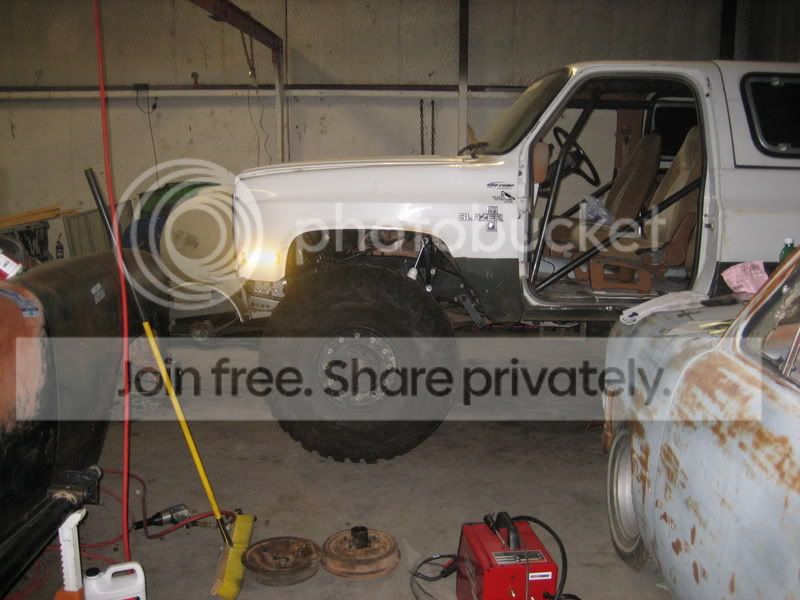

Finally sold the suburban (thanx acprokeith!) and decided OL14BLAZ(Eric) was too close so I bought some 42s with 12 bolt H1 beadlocks. Thanks to both!!!
Oh and thanx to Westtexask5 for the RTI ramp donation.
Couldnt flex it out all the way. Still needs a bit of:hack: !!!

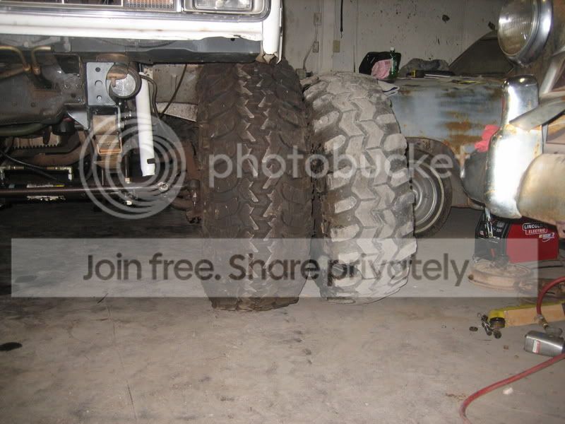

nice rig !! are your hummer beadlocks widened or recentered ? i should be picking up some later this week and im HOPING to mount my 44 inch boggers on them :D
Stock H1s not recentered. Just running DRW hubs up front and van width 14FF out back.

that cage is awesome. i was thinking about doing one just like it to mine a bit further down the road. im guessing that you made it?

Thanx.:D The cage is part S&W and part me. The front is coming out and being changed up a bit and more cross bracing will be added to the rear.

Ya they were just bolted up for testing and cutting. They still have the rubber runflats inside so those will come out for some PVC. Tire, wheel and runflat weigh almost 200lbs:eek1: so I dont want to mess with them any more than I have to lol.
did you ever take the runflats out and get the pvc's in? are you just running 4" lift? looks good. thats definitely my next combo, i love that they dont balloon much
