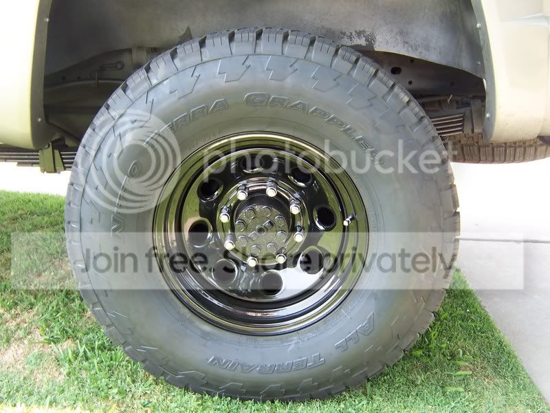

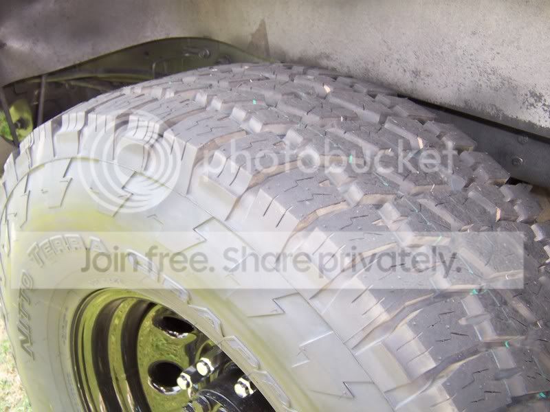

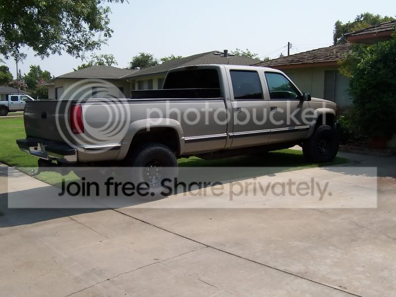

This could go in the IFS, tow rig or even the lounge... iono so I dumped it here in the garage... it's a truck and it's kinda tech related :)
Anyways here's some pics... I've been driving on them this weekend and I LOVE the setup... had to trim a little (temporary until the tube bumper goes on the front) but they run smooth and straight as an arrow even at 75mph+...

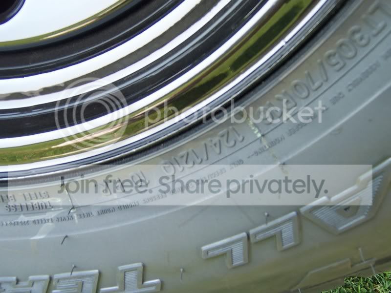

305/70-16 Nitto Terra Grappler Radial, Load range E mounted up on a set of 16x8 Black Steelies w/ 4.5" BS...
Pretty much silent... with the windows up I can't hear them at all.
I have a thing for SRW crewcabs -- they're so often duallies, ya know, so the SRW ones are just, I donno, tidier looking =)) That's why I didn't want the big fat fenders when I converted mine to dually.
So those are basically 33x12.0's, huh; I'm surprised to see load range E in that. Generally LR E's are skinny tires.

Yeah that's why I went with these... 33/12.50-16's in a Load Range E...

Technically 32.8" but I'm not sure in real life...
I'll measure it tomorrow... although I can say they didn't squat hardly at all even after the weight of the truck was on them... 10 ply load range E is the only way to go on a 1 ton apparently :)
I've got a set of 305/70/16 Widetrack MT's that measure right at 33". I was just wondering how the off-brand would compare size-wise to a name brand.
I'm sure we're within a 1/4"... it'll also depend on how wide a rim they're mounted on as well as how heavy the vehicle is... heck even tire pressure and how much tread is left... but I know they're right at 33".
Looks good man.
Thanks... it'll look even better once it's black and has the tube bumper up front...
Avery, can you get a width measurement too please. I have the 295/75/16's on my tow rig, I like them but they wear quick and are only D rated. I like the idea of an E rated tire especially since my trailer is about 15-16K loaded.
3" body but I think after 126k miles the front t-bars are a little saggy... and yeah I'll measure them on the truck tomorrow and get back to everyone...
Looks good Avery! I love the black steelies.. very nice look on that truck.

I love that truck. Get a big ass bull bar on there and you'd have the perfect urban zombie hunting vehicle :D
nice rig...damn that's a long truck!!! like the camo one too...still debating if that's the color (camo in general) i wanna paint mine...always wanted a camo truck...

WOW! That is a good looking tow rig right there! :waytogo: I just bought some new tires for my tow rig, I was actually wanting the same you have but, in a 265/75R16E variety (no lift) but, there's a shortage of my size in those tires out here so, I had to get something different. Anyways, looks great, I hope they are working well for ya!

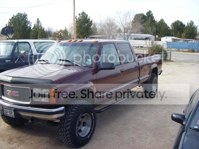

my dads truck has a 3" body lift and he cleared 35"s
I've heard that from a few people... to be honest I'm not sure why it's so tight. I know it's a 3" BL but I'm maxxed out with these 33's... the back could fit 35's but the front would hit all over the place...
Did he crank the torsion bars?
