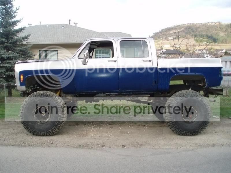

Should look like this, but not as tall and not as much tire. This is a slight chop of someone's rig here (Diciples performance)

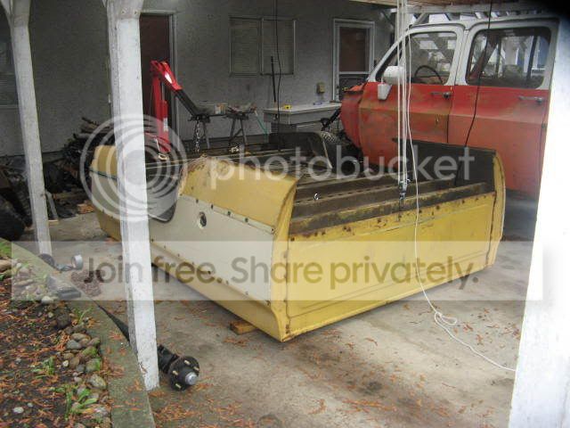

Donor box...

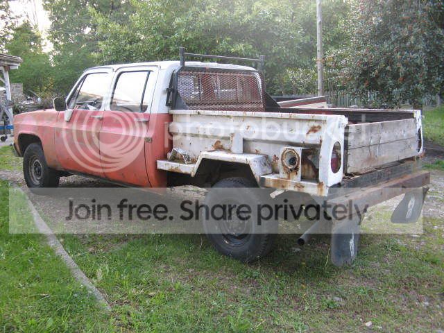

Truck I'm starting with (she's a real beauty! lol)
