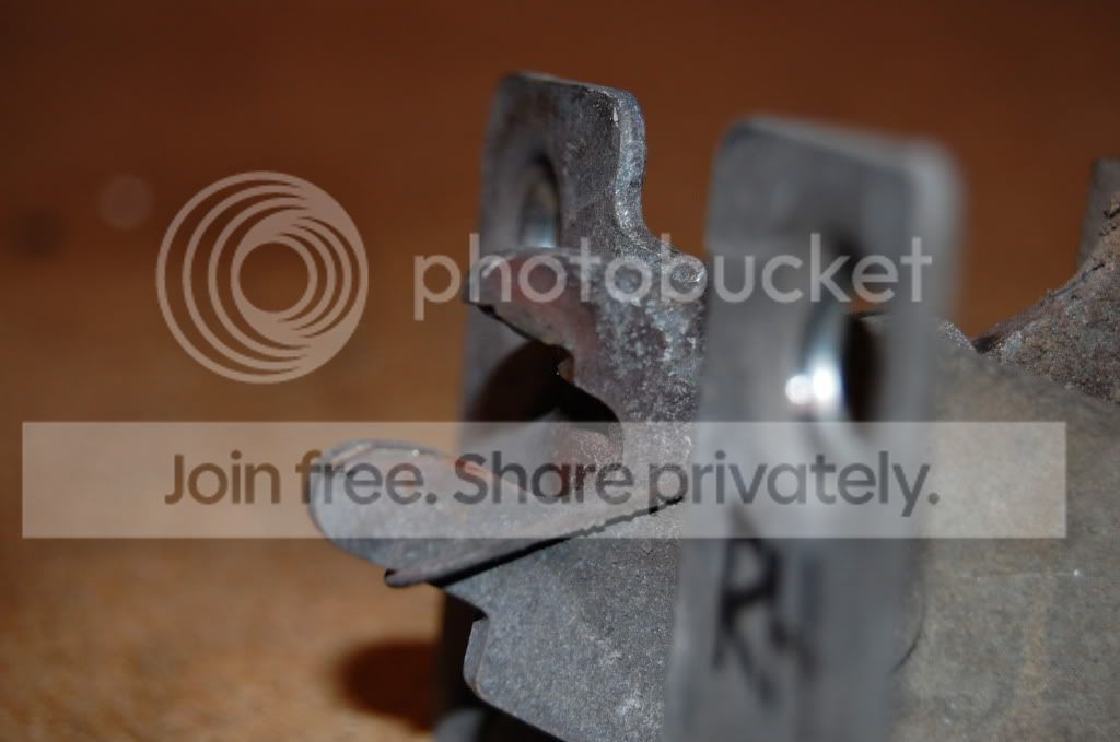

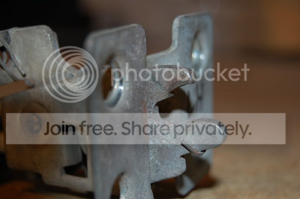

I'm thinking I'll just end up dis-assembling the latches, and fabricating the worn latch arm and then re-assembling. A bit dramatic, but not 300.00 (insane).

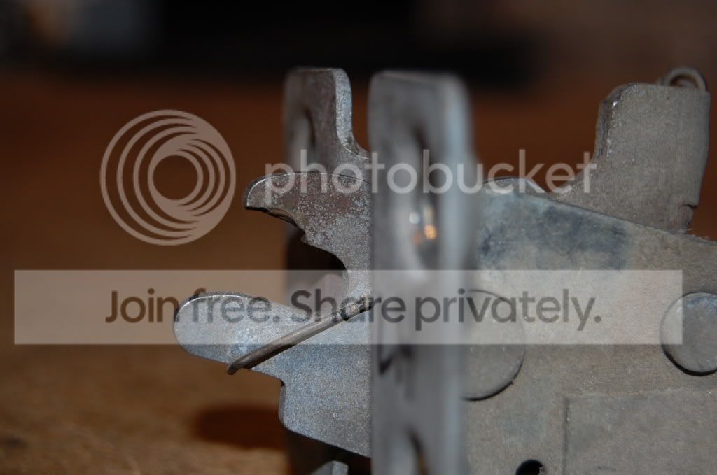

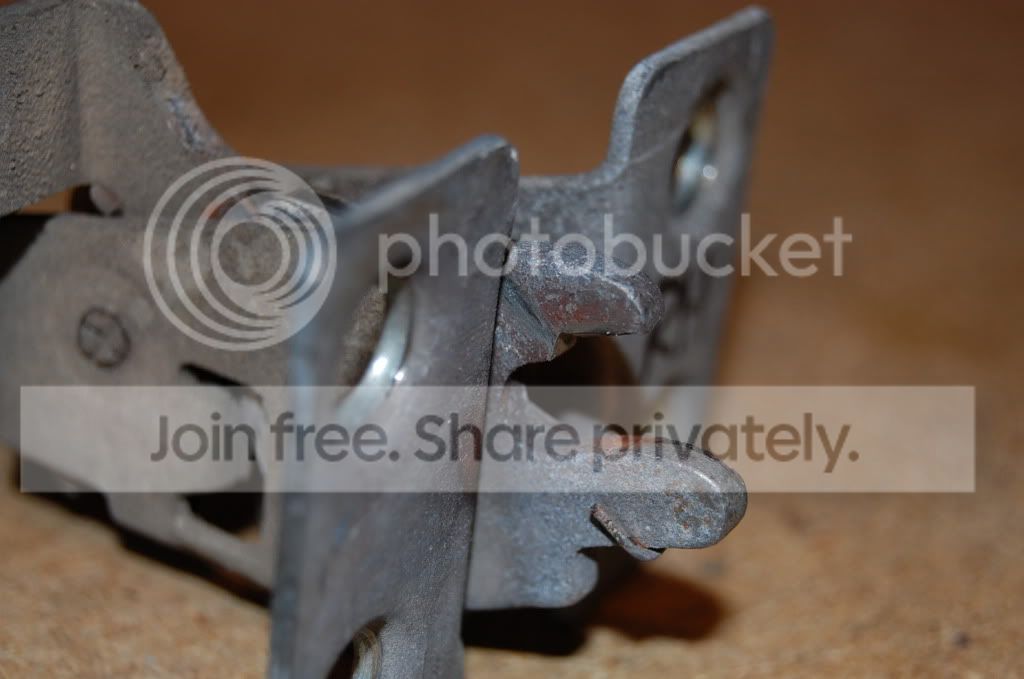

The latch arms have worn slots in them. In combination with the worn striker plates, there's a little more than 1/4" play on the tailgate. I have new striker plates already - That was the easy part apparently. :doah:

I would suggest welding up the wore out part then carefully get a small grinder to shape it correctly and be done OR find a good set at your closest junk yard.

Well, I'm going to throw in an idea that I have no business doing. I have no GM products to check on this with, and I'm going by memory.
That latch piece looks really familiar. Over the years, I have adjusted latches on lots of different types of vehicles, and that shape is real common.
With that much wear, the pivot bolt or rivet for it is going to be worn too.
My idea is to compare just the worn part with other model latches. A car company loses profits when it has to design and build a special part for different models. So, they tend to do as much part sharing across model lines as they can.
The entire latch as a whole might be different, but that does not mean it doesn't share parts with others.
If so, you might find a unworn latch in a junkyard off a newer model, grind off the head of the rivet and replace just the arm.
You really need to pull that part out anyway if you are going to weld it up to keep from drawing the temper on the spring.
Putting it back in will be tricky. You almost certainly will not be able to use a bolt because the head and nut will stick out too far.
A dome head brad on type rivet might work, but I would think about a countersink or dome headed stripper bolt.
Cut the threaded end off close and spread it with a chisel.

I didn't consider the cross ref possibility. I may check the yard if it comes down to that. Right now I'm almost stuck on the idea of fabricating the part. I'll be popping the one rivet on each latch tonight and taking pics - It really is a simple piece to make.

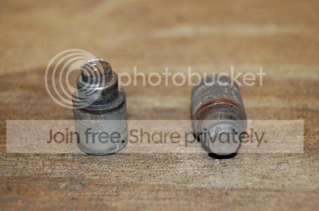

The rivet will be replaced with a shallow head pin, with an E-clip on the other end - It can't get much cleaner than that (Less obstruction than the original rivet).

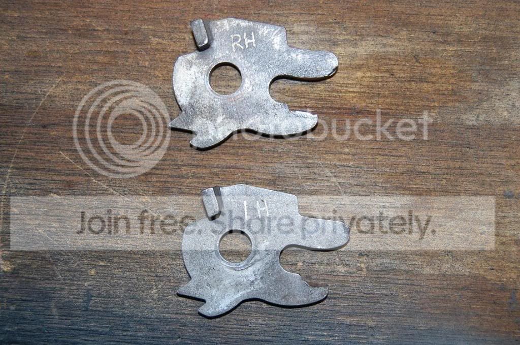

Without knowing what is on the other end of that piece, I can't say for sure, but if you had one for a pattern, it would be a no-brainer for a wire EDM machine.
Or heck a regular CNC milling machine would make short work out of it.
For that matter, time, patience, a hacksaw and dremal tool would do it.
At about $170 a pop for new, there might be some money in a rebuild kit. You could charge $60 for a new part, pin, and instructions..........
So who knew the left and right latches were identical ?? :dunno: Still simple in design, and should be easy enough to duplicate.
The solution for the pins, however, changed real quick when I popped the first one out. But, it just became even easier to retrofit. I'm going to drill and tap the top (where the pin was crushed, and now flat) with a fine thread for a pan screw with lock tight.
It would be a good investment IMHO for an individual to market a repair kit. But that's without knowing the costs for everything involved.

I'm going to use steel for mine if your pair leave me empty handed. Maybe even 3/16 (These are 1/8). I'll check measures prior to the fab though.
What makes you think a fab'd latch wont last or be as durable ? I agree about the welding fix - That would seem to only be a temporary fix. But a fresh, one piece mirror of the latch ?
