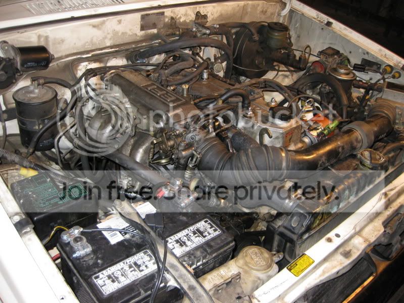

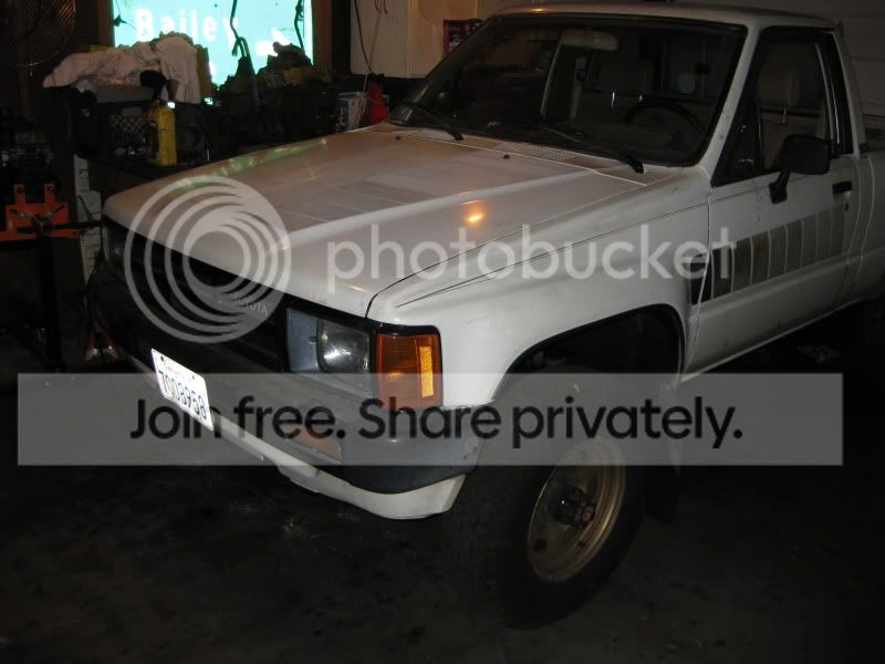

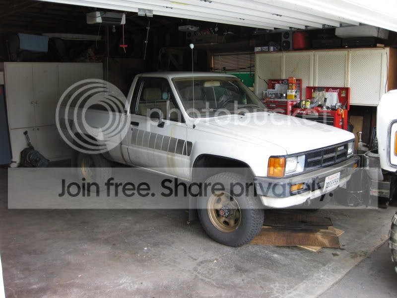

Picked up a new toy. Here is a pic. 500bux, couldn't pass it up, even if it sits for a while.
Its got a 22re, that leaks oil pretty good, everything else on the truck is great. No rust, AC blows cold, sr5 package, Solid Axle, 240k, 5 speed, etc.
Most likely use it for the snow, camping, and hauling. The only thing that sucks is its white. All of my rigs are white now, and the last 3 ive owned were white as well. Oh well.

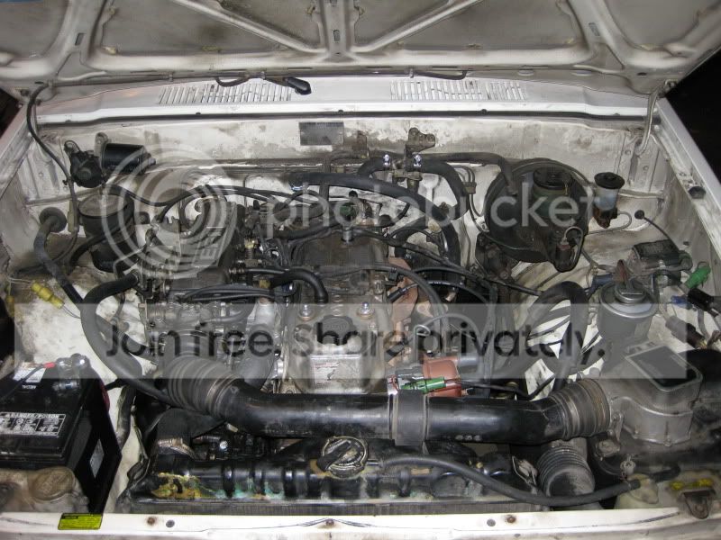

updates, I ended up pulling the 22re out of the truck and replacing the long block with an 86 22r, then reswapped all the fuel injection onto the motor and swapped it back in.
The old 85 22re motor: which had lots of aluminum in the oil pan, which I suspect to be a timing chain stretched bad or the hydro tensioner went bad, and took out the cover with it. 240k.

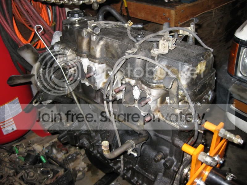

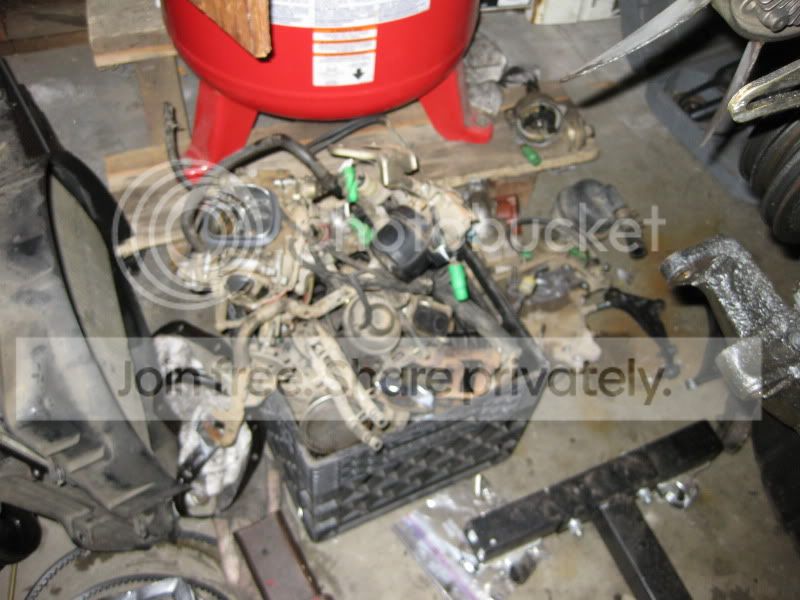

the pile of parts off the carbed 86 22r motor:

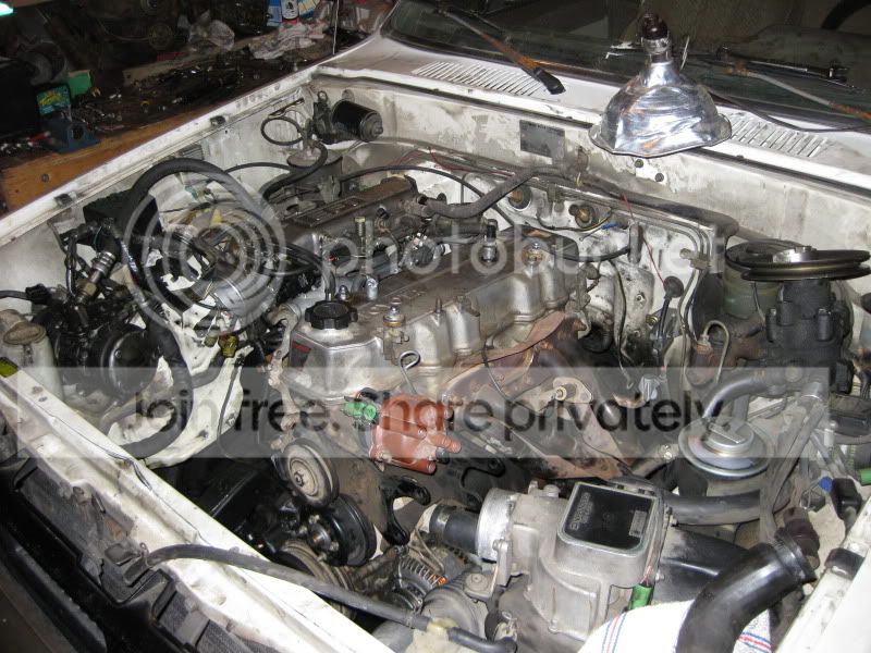

the 22r with all the swapped parts to make it a 22re:
another:
still have a bunch to do until its running again, but it should be good to go for a while now. Will use this truck for the snow, and long haul trips that may require 4x4 and to replace my 1980 2wd with as I let my sister use it for a year or 2.

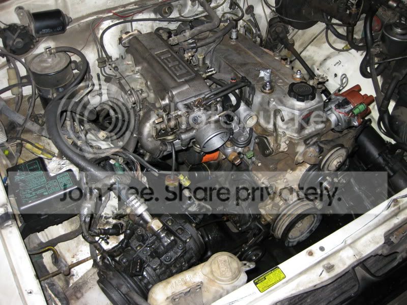

got everything finalized except the exhaust collector to the pipe. Doing that soon, started it with the straight header for a second and it was loud. Here is more pic whoring

Put an Optima red top battery in it from my other 2wd Toyota that I sold along with an alternator because the old one was pushing 17 volts:eek1:, and put a radiator in it as well along with a stereo. Went to DMV, paid the registration and got a temporarly operating permit. Went wheeling in it on last Sunday after thanksgiving, then smogged it on Monday, passed no problem even with the downey header...DMV wants a weight cert., so I got it weighted and its 3180, not bad for a 4x4, still learning how to wheel a stick though definately different.
