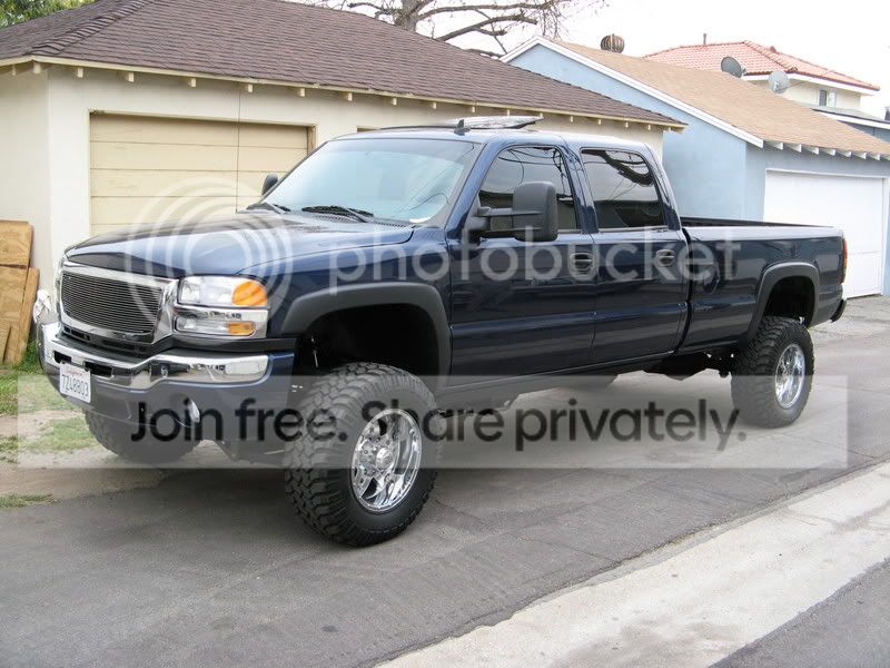

2006 cclb, febtech 4" 35s (it's too high in the back now, we don't have a camper anymore and the boat/utility trailer tongue weight is light) This needs hydro assist steering, it's impossible to turn without rolling. Some Bilstein 5100 made a nice difference over the shocks that came with the kit. As of 85k miles, lower ball joints, both hubs, and all steering parts have been replaced. PS> The Nitto Mud Grapplers are much quieter than the Pro Comps. I don't know about wear yet.
