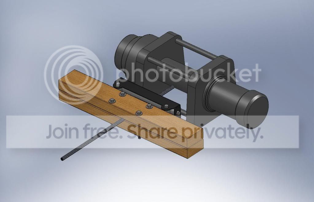

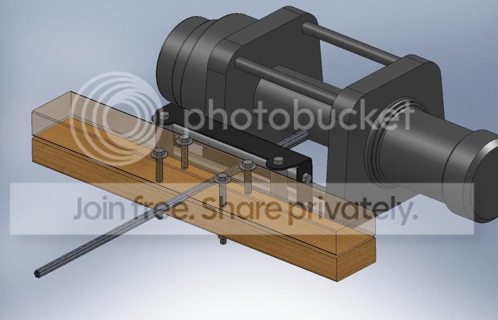

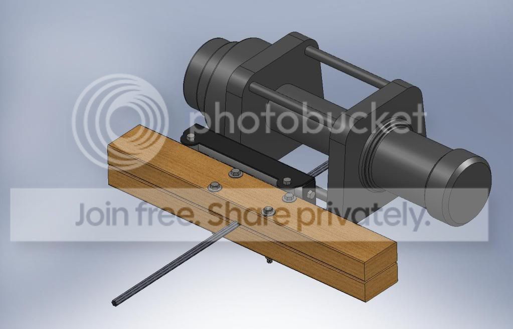

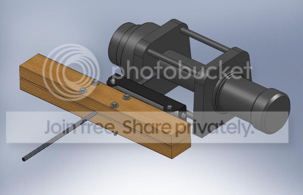

I used to park my rig in a field, string out the cable, and hook to a big rig wheel/tire combo that lays flat on the ground (24.5 steel wheel + heavy tire). Then spool in the cable, and while it's dragging the wheel/tire across the field, guide the cable smoothly on the drum.
Works great, but moving that wheel/tire combo is a pain in the rear...
So I designed this simple device that lets you wind the cable under tension, and guide it onto the drum without actually putting your hand on the cable (any burs in the cable could cut your hand..)
Use a good quality hardwood, and some bolts with fender washers, and you're all set to make one of these. The boards ride against the rollers while its spooling, so all you have to do is slide them from side to side to guide the cable.
Pictured here: (apologies for the under-detailed model)
Has been working great for me...
