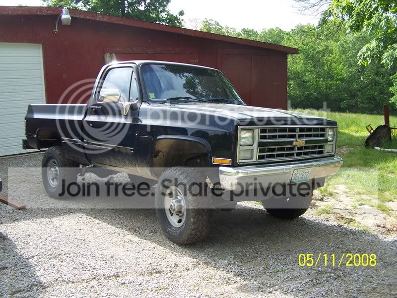

here are pics from supersize75k5's build, hes got those rims with the XL's, i think it looks pretty good

I have a set in my shed. Their backspacing is around 5". I'm running some of the steelies off of a 2007 on Big Ugly and their backspacing is around 4.75" or so. If you're running a narrow tire they work well and keep the tires under the fenders. However with the stock steering it'll be pretty easy to tag the drag link. I had to limit my steering to the right to keep the tire from eating up the drag link like the last set did.
