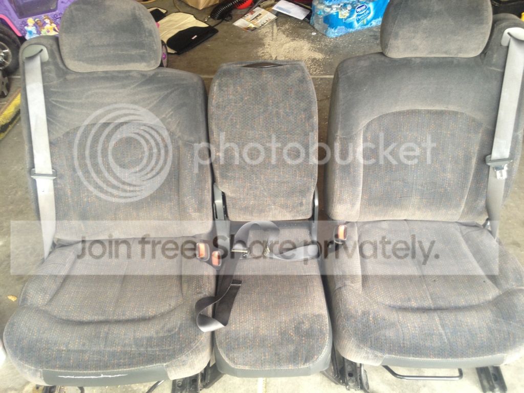

Has anyone that has installed these seats had any issues? My main concerns are the center hump in the front, and finding a good way to mount the rear seat. I am hopefully going to pick them up after work tomorrow, that is unless someone here claims it will bring on the apocalypse.

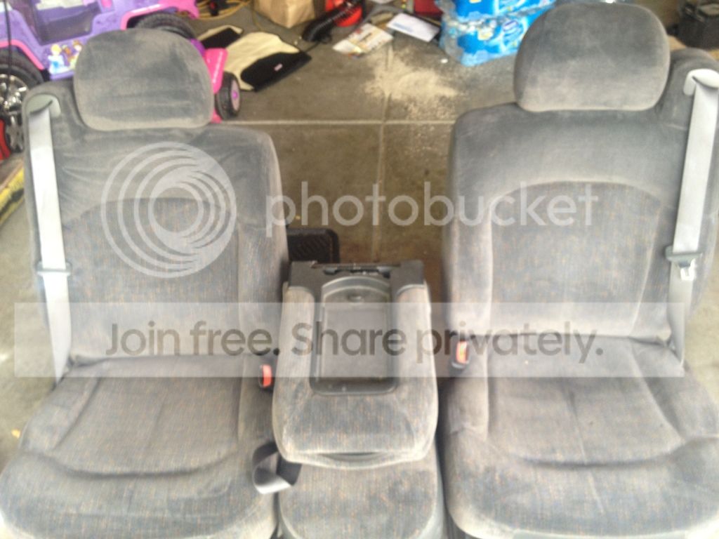

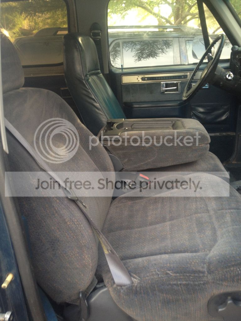

I picked up the front seats yesterday, they aren't perfect, but can't be beat for $120. They need a new plastic piece on the console and I will eventually get the front and back reupholstered in something that I like a bit more. I couldn't help myself once I got them home so I took out the passenger seat and center console do I could put in the new ones. Looks like they are going to fit perfect.
On another note, how hard is it to reupholster these? I have the new skins...how hard is it to change them?
Those look great!
I have heard mixed stories about reupholstering seats. I tried once, a long time ago, and it was a nightmare. I'm sure more handy people think it's easy.
Personally, I'd either leave them or hire a pro.
