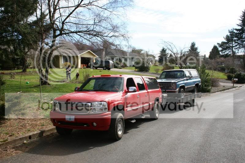

I picked up this little jewel a few months back for a song - now I'm finally trying to get it running.
