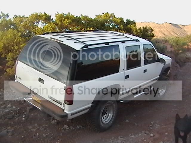

since the 86 project is just about done, and I am getting tired of my tires rubbing on my burb..
nabbed a 4.10 furd 3/4 ton front for the right price... and I already have a tapped knuckle for cross over..
I plan to start the hackery during october, I saw another burb lifted 4 inches...then saw the cost of the lift, and when I factor that I want to keep this thing long term, I think I finally am ready to do it :)
ill be doing my homework over the next couple weeks and doing it right
I am planning on just a 4 inch lift right now, but may go to 6 inch and get some 35's:thinking: plan is to stick with a all terrain tire since I daily drive this.
