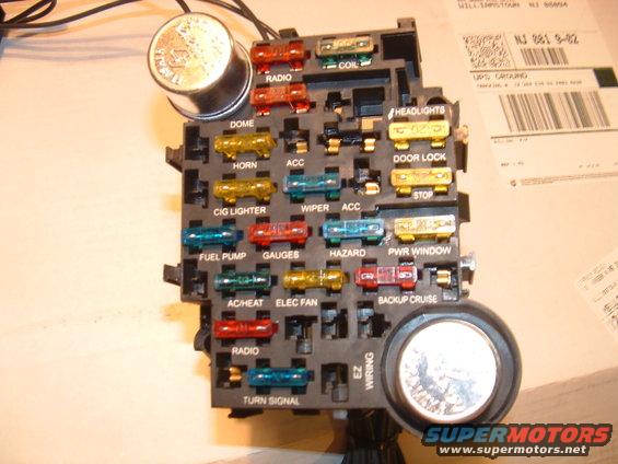

fyi my ez-wiring 21 harness
^^^ fyi the silver can is in where headlights arrow points... and red fuse where Gauges are.. is good... so more to come...

BTW, DOT regs require a self resetting breaker on all headlight power supplies. Many cars have them built into the headlight switch. Yours looks like its on the fuse block.
