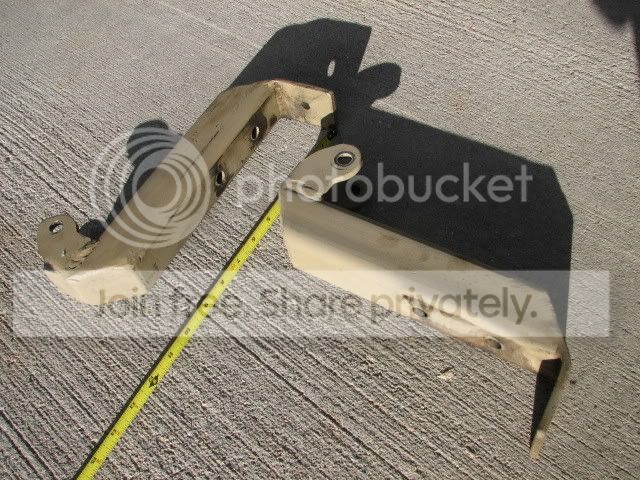

I made mine out of some angle iron
I positioned them straight up, so I had to relocate the brakeline brackets.
It was a little tricky to get them to clear the steeringshaft though.
I didn't have to drill the frame, I used existing holes.
I am assuming with the two above, the shock would go outboard of the steering shaft?
