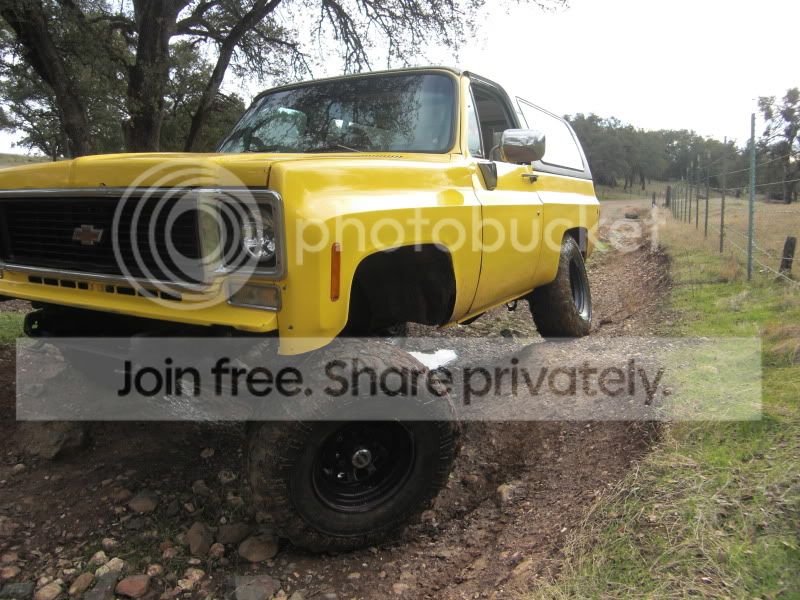

Here is a reference pic of 4in springs on 36's
