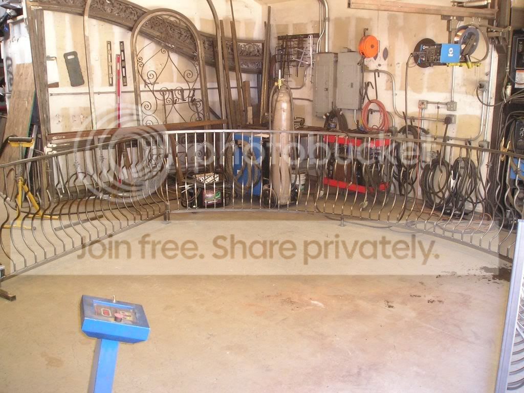

Smoothest migwelder I've ever used is the SP22A wire feeder with a seperate 200amp power supply, cant remember model #. Pic-
Upper right corner of the pic you can see the feeder on the swinging boom, power supply very upper right corner. I never knew mig welding could get that smooth. Almost as much control over the puddle as you do with a TIG machine. :eek1:
