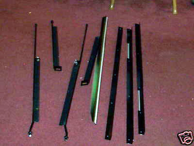

By the looks of the bows i'd say it's for a 73-75. The pieces that go above the door glass have a bend to match the doors of a 73-75. Those pieces are straight on a first gen and the bows are bent a little closer to 90 degrees.

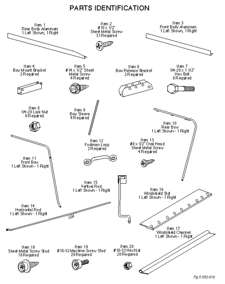

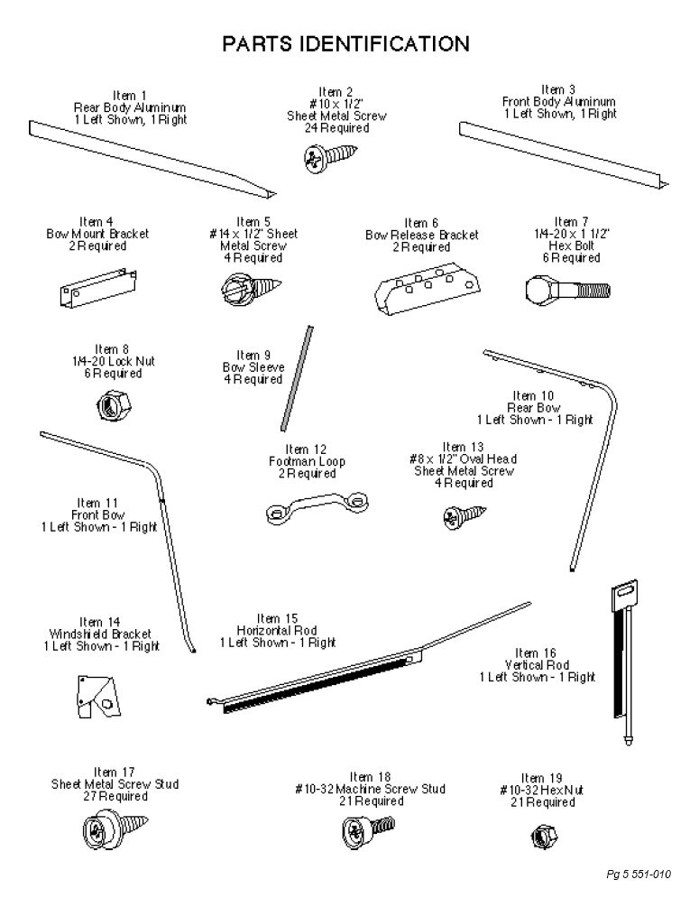

Ok, here's what I'm looking at:
Here's the parts from the auction (enhanced picture so you can see more detail, his pictures were very dark):
Here's the 69-72 parts from STC's instructions:
Here's the -73-75 parts from STC's instructions:
The 73-75 door glass piece vertical rod has a much larger bend in it at the bottom than the 69-72 piece. Just MHO. I have my old kayline 73-75 door glass vertical rod as well, it looks just like the picture for the 73-75.
Now, looking at those pictures, it seems the parts from the auctions match closer to the parts from the 69-72, does it not? I'm not the best 'looker', opinions welcome, of course!
