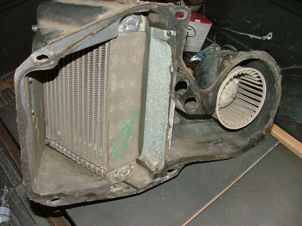

I'm going to need to notch my A/C box on the firewall, will this affect performance of the A/C? I need a 1.75 tube to pass through the side.
I plan on doing it with fiberglass, will this be a issue?
As long as you make sure not to hit the evaporator, and rebuilding the area with fiberglass is what we always did.
It won't affect the performance.
I talked to my local mad scientist that I trust his opinion on and he said the same. Now to learn how to use fiber glass.

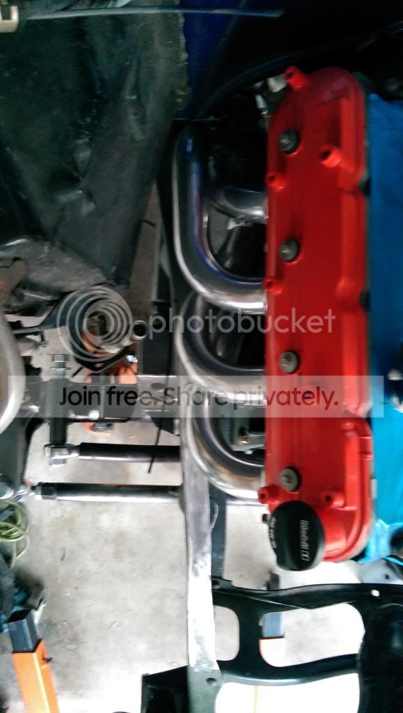

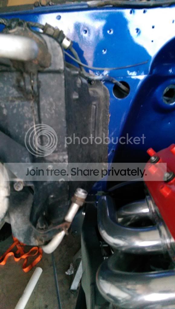

Looks like I have tons of room to do my slight modification.

Very nice, Biggest issue I see as of right now is figuring out what to put on the back side to create the shape I want then being able to pull it off.
So you're just passing some DOM through it? take a papertowel roll or something of the like and put some painters tape on it then put some glass on it for your shape, the painters tape should keep it from sticking too bad and you could always sand the tape off.
Notch the area out, lay your piece in and glass it to the evap housing.
