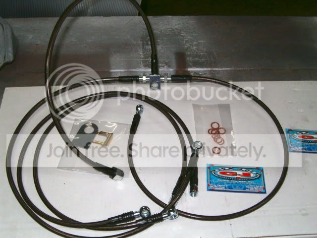

Got them ordered up. $48 and some change for two 24" braided lines with mountable ends and a few fitting i needed. I'll take that any day.
