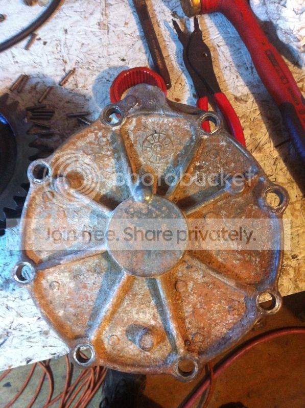

I was cleaning my 205 getting it ready for a rebuild and paint and looked at my cover on the back. It has this bump near the middle and a hole on the inside like it's an oil hole. The date tag on the PTO cover says it was made in 84'.
I remember reading on here or pirate that if the case has that then it's a syncro'd case. I plan to use this for a doubler, will there be any issues using this case? Also, are there any differences in rebuild kits that I should know of before I buy one? It had a slip yoke on the rear, I already have the stuff to convert it to a fixed yoke, can I go ahead and do that or will I run into an issue?
I'm probably over thinking this thing, just curious why some had it and most don't.

That is indeed a syncro'd case. They're ok but if you ever want to do a 32 spline front shaft conversion you'll have to replace everything from the fork down.

That NP205 works fine for a doubler. The main downfall to the synchro case is that you can't upgrade to a 32 spline front shaft without getting a non-synchro case for parts: the front output, shift fork, shift rail, high and low gear, etc. are all different.

Oh the rebuild kits should be different or all inclusive because the bearing in that cover is different at well as the shift fork design.

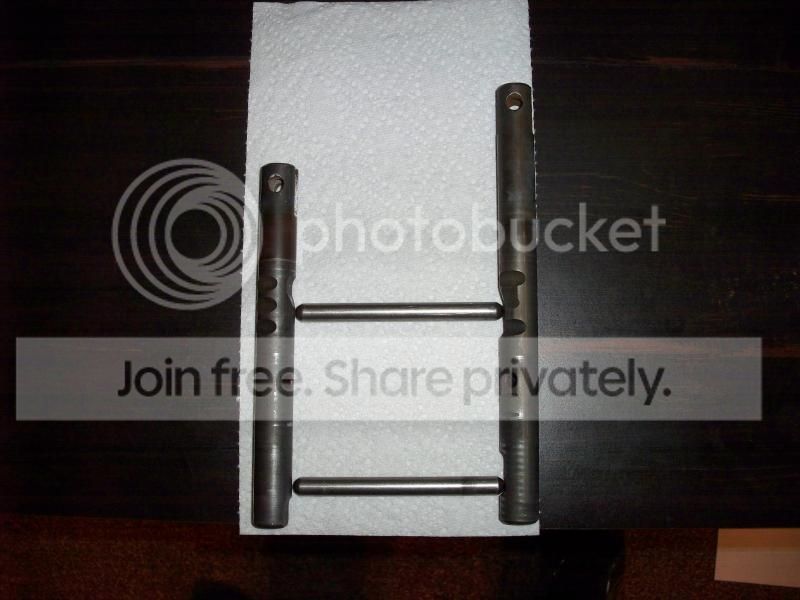

I've never even messed with a 205 before this one, much less modified shift rails, so maybe I need to do some more research before I start destroying my stuff. What on the front shift rail needs to be modified?
After reading the thread I posted earlier and looking at the pictures, I was under the impression that the rear shift rail was the only one that had to be modified?
Here are the shift rails out of my 205. I thought I'd just have to cut/grind the spot next to the detents on the rear shift rail so that the "flat" would be extended to the neutral position, then add the ramp like it is stock. Then cut/grind the rear shift rail at the end so that there isn't any material in the way when you shift it that way.
Here's the picture from the thread I posted. It looks like this is taken after the rail has been modified.
attachment.php
I'm reading on Pirate that people grind the neutral detent on the front shaft so it's the same depth as the high and low detents.
Maybe I'll take some measurements and someone can confirm that the rails are different on a syncro case like I have. I'd hate to F$%k mine up and then not be able to get replacement without swapping all the front internal.
