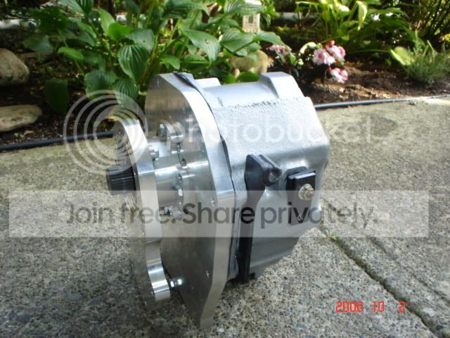

I have a pic of a 203 range box, it's the front part of a 203 tranfer case and this pic shows a small lever for the shift arm.
Directly below that arm is a large flat hex nut (you can just see the edge of the hex in that pic, and the hex is clearly visible if you're looking up at it from underneath). If you remove that nut you'll find a spring under there which is for the detent mechanism. The spring gets weak with age and doesn't allow the detent to be firm enough to prevent the case from popping into nuetral. If I recall correctly it would usually do it as soon as you let off the gas...
i added a thick washer under that spring and the shifting was firmer from range to range, and it didn't pop into nuetral anymore.
