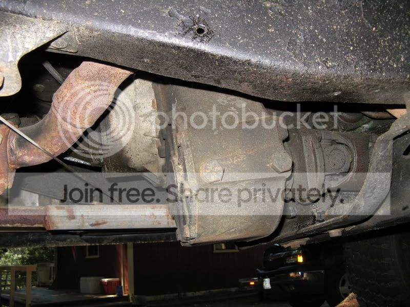

tomford 1/2 ton status Joined Jan 19, 2006 Posts 977 Reaction score 44 Location New Hampshire Apr 13, 2008 #1 Whats the shift pattern and what would make the shifter wicked hard to put into gear? this is a 203 right? Tom
guz71 1/2 ton status Joined Sep 17, 2006 Posts 387 Reaction score 0 Location lubbock/houston Apr 13, 2008 #2 yeah its a 203. Shift pattern would be : 4Low-Loc 4Low Neutral 4High 4High-Loc Shift linkage probably needs to be adjusted
D driney 1/2 ton status Premium Joined Jul 6, 2001 Posts 737 Reaction score 28 Location west central illinois Apr 13, 2008 #3 Pull the boot off the shifter in the cab and lube the shifter mechanism with some light oil.
AZ79K5Project 1 ton status Premium Joined Jan 15, 2006 Posts 2,216 Reaction score 120 Location Arizona Apr 13, 2008 #4 driney said: Pull the boot off the shifter in the cab and lube the shifter mechanism with some light oil. Click to expand... x2 on this.
oatsk5 1/2 ton status Premium GMOTM Winner Joined Aug 18, 2002 Posts 2,047 Reaction score 308 Location Grand junction CO Apr 14, 2008 #5 it wouldnt hurt to pull the hole assembly and make sure there isnt any mud packed in it
