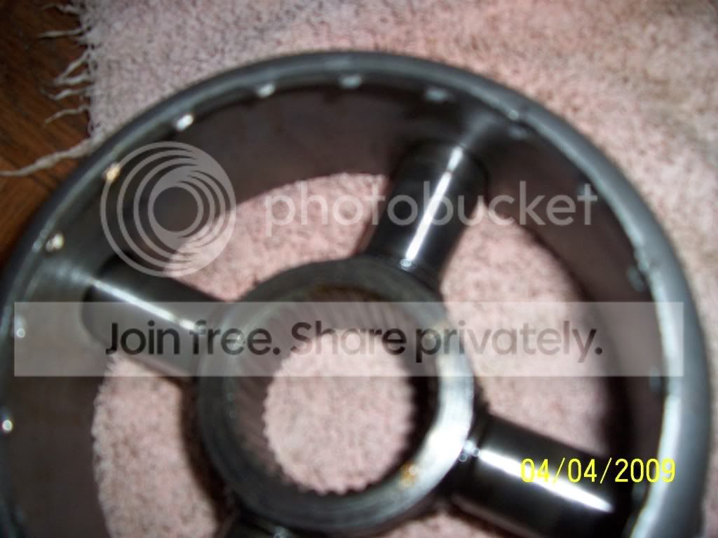

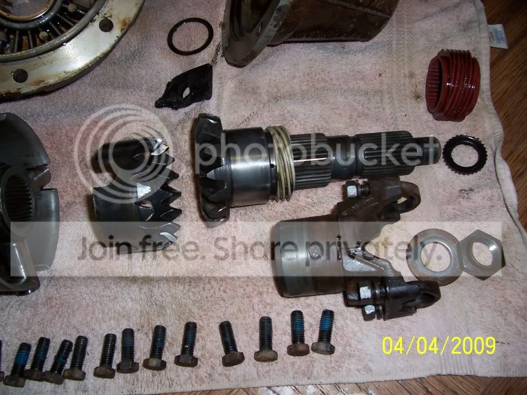

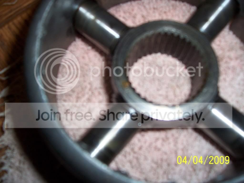

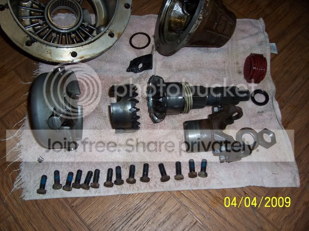

My 4by quit working. I read a post on installing a part-time kit and thought to take the tail shaft apart to see if the chain was broke or the part time kit gave it up. The shift rail and the fork inside slide like they are supose to. The chain is good. The round stamped piece with the cross like it came from a differential has striped teeth. Those on the piece to engage the 4by does not look to worn. Just for some reason the stamped round piece that has the cross in it has striped teeth. This is made of cheap stamped metal. It is not a mile marker or superwinch set. The hubs on my truck do not have a brand niether. I do not want to spend a lot but would like my 4by to work a bit more. Any idea who else use to or still does sell part-time kits? I do not think i can go with a kit from someone else because i may not have the original parts that some require. If i find a cheap one around i would even go back to full-time. Just need a cheaper way to get this back together. I looked on craigslist and will keep looking for a cheap 203 to get the parts from to fix. Any other ideas or places that you can think of that made these kits to where i can get this one part? (The outside ring in the first pic.)
