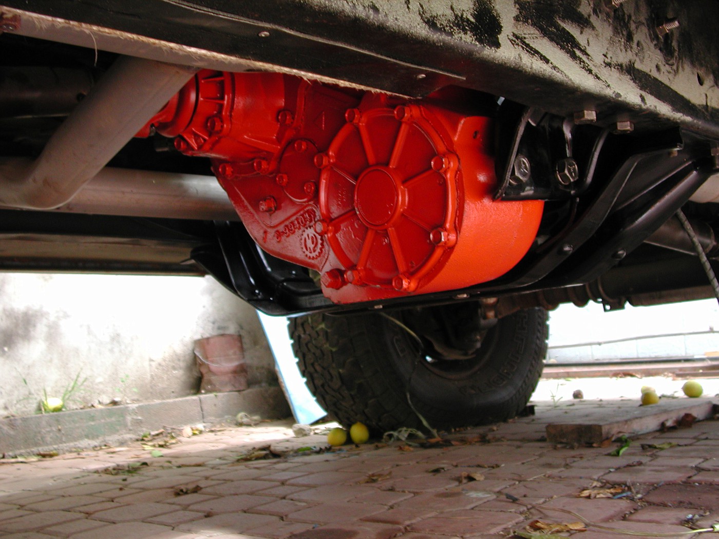

As I stated at the other board, I know for a fact that the 205 crossmember has about an inch more drop than the Dana 20 crossmember. I tried to put mine back together with the Dana 20 crossmember when I swapped to the 205, and I had the same problem as you. Luckily, my parts truck was a '72 Blazer that came with a 465/205. When I compared the crossmembers up close, the difference was obvious. With them sitting a few feet apart, you never would have noticed. The t-case hits the floor pan behind the hump, not a high hump/low hump issue.
This is the best pic I could find YJ.
There couldn't be more than an 1" clearance between the T/C and the floorpan.
This is my 71 Blazer,no body lift,no drive line mods.It sit's in it's stock position.
Thanks for the pics and info. Mine is actually touching the floor. Went ahead and bought some stuff today to add 1" spacers to drop it down. Hopefully get that done tonight or tomorrow.
I do have the correct bracket to connect the NP205 to the frame so hopefully it lines up when I drop the t/c 1".

[ QUOTE ]
[/ QUOTE ]
what kind of paint is that you used?
